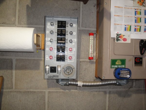

  19. Erik B
    Erik B
    May 12, 2015
    5,352
    36,402
    Western Wisconsin
    Chaz I have a 6.5kw genset and I put in a manual transfer switch. I actually paid an electrician to put it in. I can't power the whole house all at once but I did provide genpower to the necessary circuits like to the frig and freezers, well pump, furnace and a few misc outlets. Transfer switch is good for 10 120v circuits but you can strap a couple together for 220, I did that for the well pump. I have to switch the circuits in and out while on the genset so I don't overload the genset. I have a heavey duty 4 conductor cord that goes from my genset to the switch.

  20. Chaz
    Chaz
    Jan 27, 2018
    8,684
    61,455
    Southwestern NY
    Very nice install.:thumbs::thumbs:
    Ours is much more basic than that, but it works, and that at the end of the day is what counts.
    Although now seeing your setup, I feel inadequate. :(
    J/K.. but I definitely like the system you have installed.
