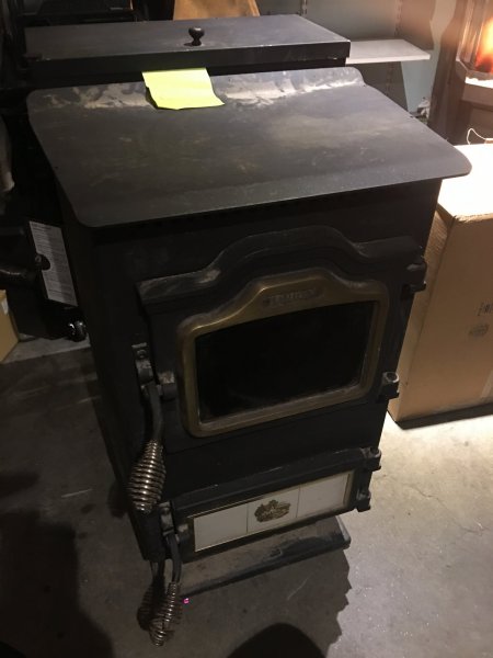

    Pic 1 - Old Blower and housing

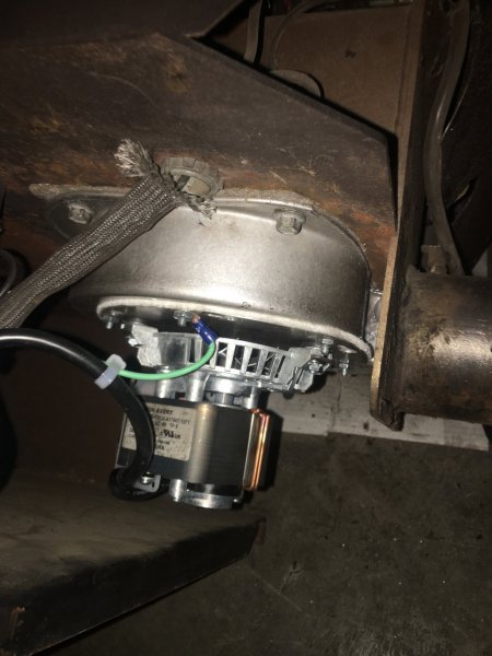

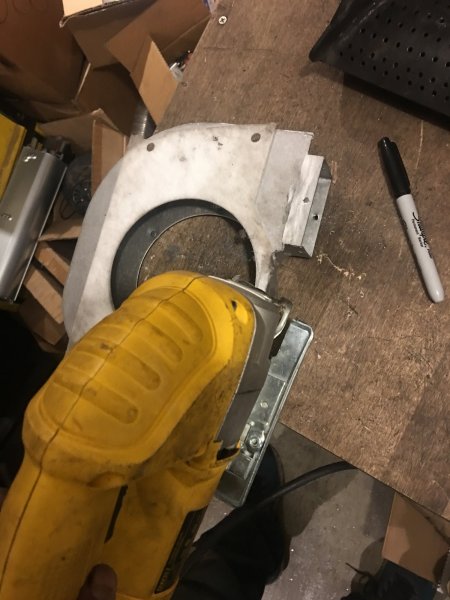

    Pic 2 - cutting the new quick change housing to fit. New housing has studs with nuts for easy exhaust blower installing and removal. :)
    See hole cut off with jig saw on right side
    Pic 3 - Mounting holes may also have to be elongated with a drill bit to align with holes

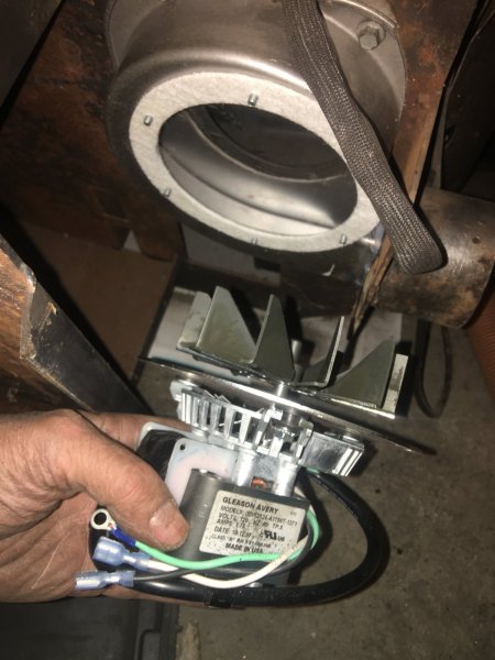

    Pic 4 & 5 - New 1.75 amp High Quality Exhaust Blower!
    Pic 6 & 7 - Harman Pellet Pro II

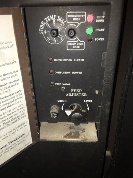

    The older Pellet Pro I has a Control Panel that looks like the old Earth wood pellet stoves!
