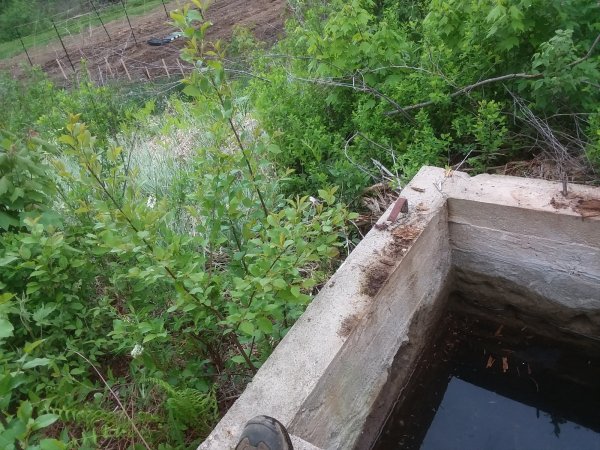

    Ideas to get semi pressurized water from an old well to the garden. Needs to come up 3 ft out of the well, then down the hill only 20ft. No power or air. Siphon?

    How low will the water in the well drop once you start taking it out? If not much, why not just drill a hole in the side and stick hose in it?

    Are you saying that the garden is 20' from the well? Or there is a 20' drop in elevation? If there is a 20' drop in elevation that is a no brainer siphon candidate. As huskihl said, you can submerge the hose to fill it, or use a bucket to fill it, then you and a helper hold a thumb over the ends until you are ready to start the siphon, then let go of the lower end once the upper is submerged...

    20ft away and about an 8' elevation drop

    Siphon will work like a champ. About half a PSI per foot of drop from the pools surface, minus friction loss.
