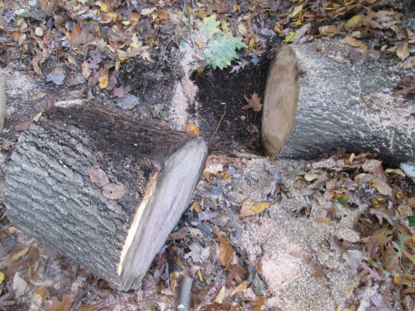

    Shovel is good. Ive used a spud bar or long pry bar to remove and/or make a depression where the kerf will be to minimize dirt cutting. If you can make it all the way underneath, try sliding bark scraps under so saw hits them instead. Scrap board or plywood works even better. I used to have a scrap of 3/4" plywood just for that.
    Slow throttle down to a crawl when nearing end of cut. I tried jacking up a big trunk once with a scissor jack and 3/4" plywood under it. Ended up bending the jack. Trunk didnt budge. 28" red oak.
    Hitting dirt is almost inevitable when making last few cuts.
    Pic is of last round bucked off a rootball trunk in dirt. Tree was 18 month old blow over. Pic from November. IMG_1259.JPG
