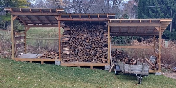

    Not a pallet wood split palace, but each bay holds 5 cords.
    I nearly have the middle bay filled now, this is an old picture. I think now it's only needing about a half cord to finish that bay.

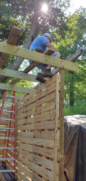

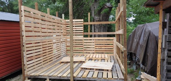

    We have 2 big sheds built from pallets and several smaller 1-2 cord sheds.
    These are some the small sheds. Left holds 1 cord, made with 4 50x50" pallets. Used 2 4x4x10 runnersRight shed holds 2 cords. Used 8 50x50" pallets on it. Had some 20 3x4 runners to go under the pallets. 0414201253_HDR.jpg Our biggest sheds are different.
    Got these equipment skids from work, each measures 7.5x 11'4" 0526201929.jpg Fastened them down to the 4x4's, then evenly spaced the decking boards. 0528202238_HDR.jpg Had to buy some 2x6x16's to fill in the gaps. 0529201956.jpg
    For the walls, we used 48x48 pallets. 2x6's screwed to the post to hold pallets. Walls are 8' high. 0608201234_HDR.jpg 0609201618.jpg 0619201322.jpg
    Used 2x8x16 to span the shed, bolted to the 4x4's, then used some 2x6's we had saved for the rafters. 0629201018_HDR.jpg
    Stripped it with 1x4x16 leftover from a roofing job. 0703200940.jpg We call it the calico shed, roof is leftover panels and screws, brown, green and blue screws...:thumbs: 0703201240.jpg
    0705200738_HDR.jpg I did put some short pieces around the bottom for rain protection. 0706201151.jpg The 2 big sheds together, right one holds 5 cords, its 7x6.5x14. 0705200737.jpg Stacking wood in the 5 cord shed... 0713201046_HDR.jpg
    Yes, we run fans as we are stacking, helps start drying.
    Hope this helps with some ideas.
    Happy building.
