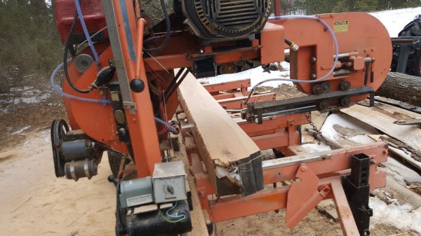

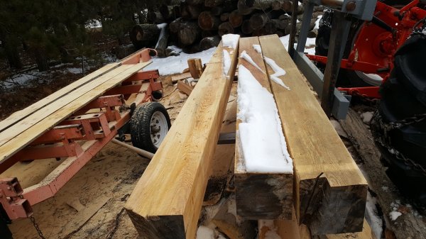

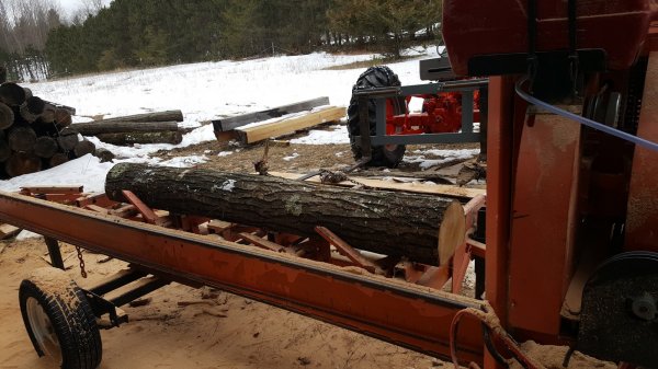

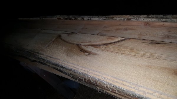

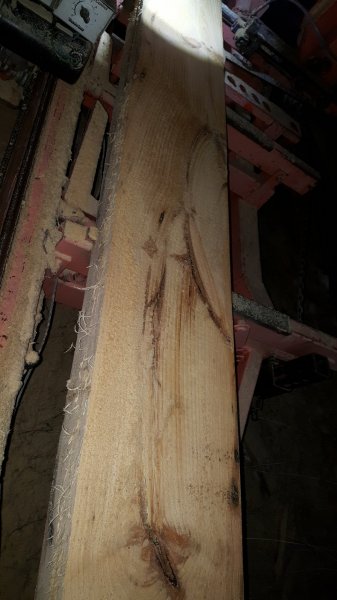

    It has been almost (maybe more) than a year since I cut. Some of my mill fodder may be fertilizer soon, so after fixing a (design) issue with the drive on the mill carriage, a tractor being torn apart, raising 3 little ones, working 55-60 hours a week, etc. I finally was able to get set back up this weekend.

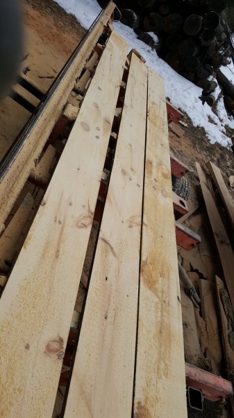

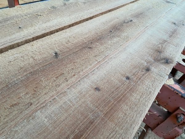

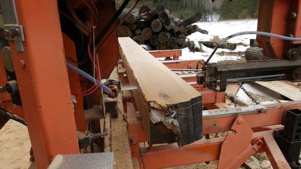

    First on the mill were (2) white pine logs that I have had for around 4 years, the outside was getting punky, but still some nice looking lumber inside. Being old as they are I wouldn't use for anything structural so I just cut into 3/4 paneling.
    I will hopefully use it to finish the inside of my woodshop, but I keep selling it because...money.

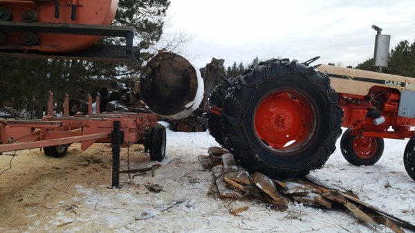

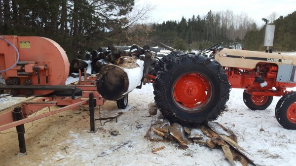

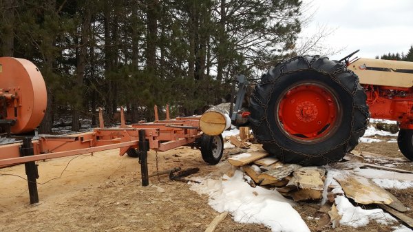

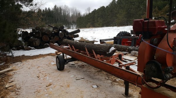

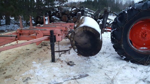

    I don't have the loader back on my tractor yet, but I did build the forks to fit the 3pt.
    However they do not lift high enough to load the mill, ground is too froze to dig the mill in, so what am I to do?
    Scrap slab for a Mickey Mouse loading dock to get the tractor taller, I am not proud, but with the rear dif locked, it worked (kinda)

    Hey- it worked, so it couldn’t have been a bad idea!!!

    Darn slabs always come in handy for something !!:rofl: :lol::thumbs: sure beats trying to winch up a ramp , Looks like some fresh paint on the tractor Looks good

    Yea, clutch was stuck to the flywheel, so I had to split it, while I had it apart I was able to get the chassis painted, but didn't get the wheels and tinwork done before cold weather hit (my shop is not heated).

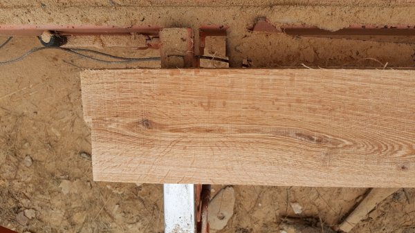

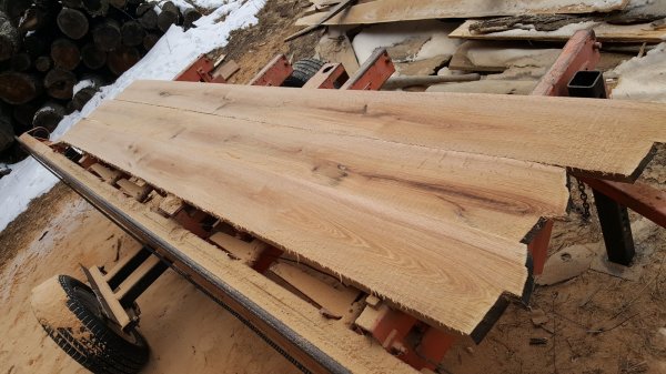

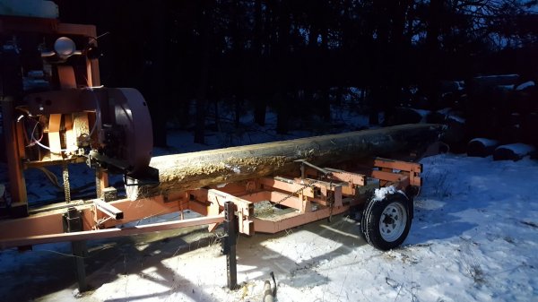

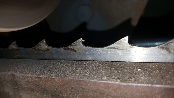

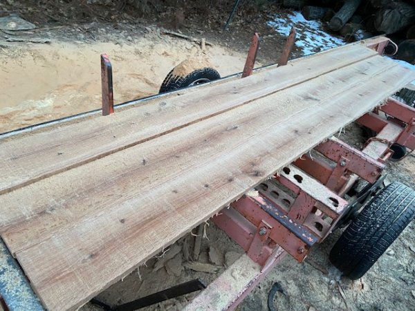

    The big pile in the pictures behind the mill is all red oak, I started into it last night. Just cutting 1" boards for a shed floor, the last board on the bottom CAN be cut at 1" but I like to leave it at 1.5" to ease the "Pucker factor" running a blade that close to the deck. The thicker pieces are going to be decking for my 6x10 trailer.

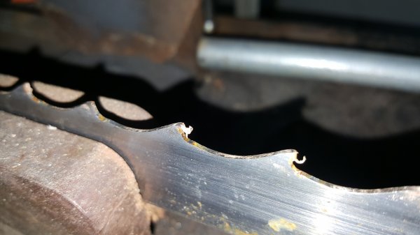

    Sharpened a handful of blades before work this morning, found a couple that cut some nails on the last use.

    I send my blades out I just do not have the time to sharpen them or the floor space to put the sharpener lucky you could save the blades usually if I hit metal it rips the teeth off :headbang:

    The sharpener was included when we bought the mill (used).
    Generally all new blades I buy semi-local (Paris All-Sharp) and I send them back there to be sharpened until they will not accept them, usually rust, bent/broken teeth, worn out etc.
    Then I sharpen until it breaks or just wont hold an edge and then I scrap them.
