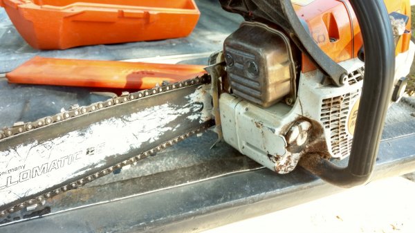

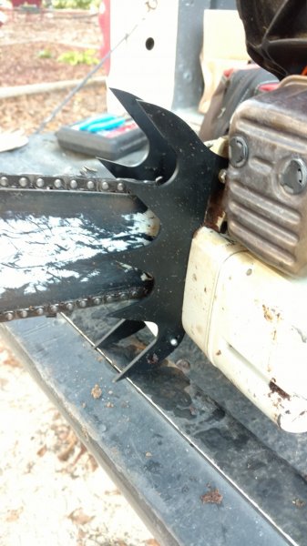

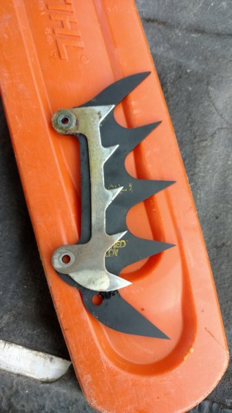

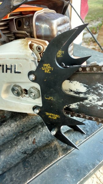

    I finally decided to replace the stock bumper spikes on the MS362. Tried them out yesterday evening. Works very nice, keeps the saw straight in the cut and farther away from the log. I've burned the bark on several big logs before. My wife said it looks like a serious saw now...like the Holiday Inn commercial, "It doesn't make it badder, just looks badder"...lol... really like them. Found out real quick I can't slide it in the truck bed like I used to...plus I've got to modify my storage case so the spikes will in the bottom...

    Sure does.............!!!! Those spikes are nasty looking (in a good way:yes:)

    Ordered them from Bailey's online. Found the M5x12 bolts and M5 locknuts at my local hardware store for $1.17...I think they wanted about $3 for one bolt if I ordered them with the spikes....ouch...

    Looks like they could be very aggressive.

    How much bar length did you loose? Maybe an inch?

    They'll make the saw feel like it has a considerably more aggressive chain on it. You'll probably have to run your rakers .005"or so higher that you used to in order for it to keep the chain from being grabby.
    Didn't mean to sound like a Debbie Downer. I just didn't want you to go sharpen up a brand new chain and take 5 swipes off the rakers and end up having to file half of the tooth away to be able to use it

    Probably that much or a tad more. I running a 25" bar on it.
