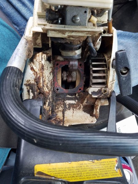

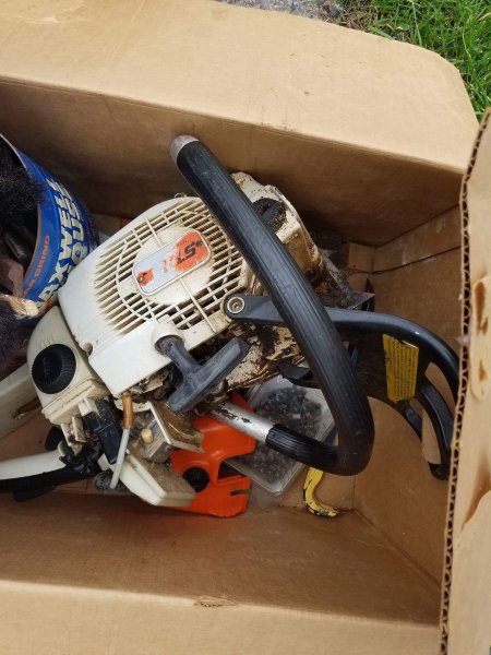

    After looking at the pics, I threw a $40.00 offer at him and he took it. From what I can tell, it may just need a P/C.

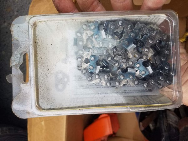

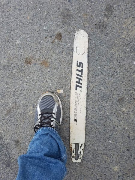

    One brand new and one slightly used chain, decent bar, heck. That stuff alone is worth 40 bucks! I'll break it all down and do a hydrosonic bath for her, and go from there......
    Just what I needed.....another project!!

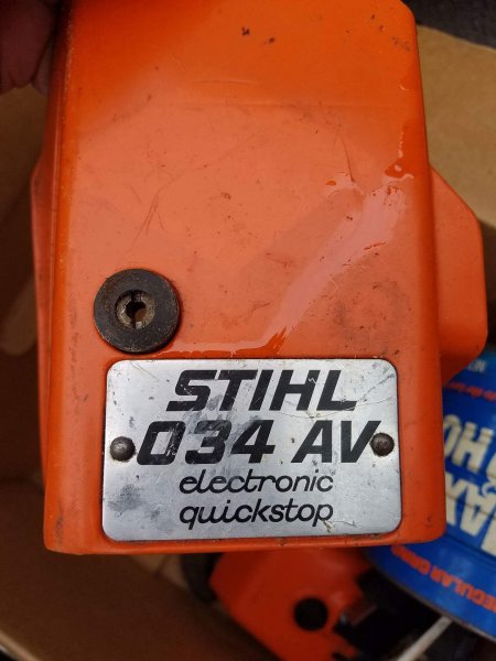

    Can someone school me on what a "electronic quickstop" is ?

    Sweet. Post a wanted ad for an 036 top end or just cylinder. Meteor has a very good piston for $34ish.
    AM seals are fine for this series. Replace the impulse (3"? Section of oem line...not molded... could use tygon). Oem fuel line is best but check diameter of hole in tank--- may not accept the 036 line but that can be changed.
    Air filter is older style. As is tank vent.
    Nice saws for sure.

    Electronic ignition, quickstop equipped (clutch brake)

    definitive dave has the P/C I need in his ebay store, I'm gonna go ahead and get it off of him. I'll break it all down first for a hydro bath, and make sure I order everything I need.
    This will be a good bucking saw for the 20" bar.....

    Oh yeah, you're going to like it. What brand p/c from his store? The Farmertec is the lower price point; I haven't used one for this saw yet. The NWP is slightly higher quality (usually) with better plating. My Hyway is close to the NWP.
    Caber rings are a nice upgrade as a lot of pro guys wear the cheap rings down to a noticeable drop in comp.
    The circlips are problematic for both so Dave may toss in oem.

    After a lot of time on 034s we've said-
    20" on 034super, 036, 036 pro (all 48mm)
    18" on 034 (46mm)
    In hardwood with a decent chain, that is. softwood? both can handle 20" easily.
