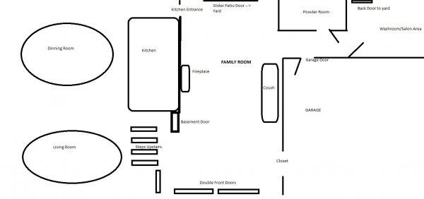

    Attached is a picture of my current FP setup. I guess we'd have to make a decision about having it as our primary heat source as I suspect I need to run some ducting into the upstairs etc. I guess for now it would be used secondary but would love to use for primary or have the potential to use for primary.
    Home is a traditional colonial 4bd 2 1/2 bath approx 2000 sq ft. Chimney is more or less in the center of the home. Chimney runs through both Attics which I can easy access to both. Firebox has a ash pit accessible from basement. Not sure if that could be used to run electric or not. Attics are insulated but not great low R-Value but in time I'd take care of that and air seal and put proper insulation in. Attached is a feeble and utter disgraceful attempt at drawing my home layout (please go easy on me, lol). All upper level sits above family room, garage, powder rm, and washroom/salon. Pull down attic in hallway. Upstairs is chilly!
    I guess it makes most sense to use what I've got in the chimney already. Family room is the place we spend almost all time relaxing and watching TV, so Ideally a good spot. However it's small room and I fear of getting overheated in that room. As we sit literally 7-8 feet from the FP. Am thinking even the smallest stove in that spot might sweat us out? I thought about putting it in the living room I could crank up and it would heat all other rooms and travel up stairs but not so sure and I would hate to put a big old chimney up through the roof in that spot. Not a fan of that big ole stainless steel tin can coming through, please no offense to anyone.

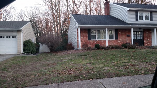

    IMG_20160111_163800038.jpg Pic of house!
