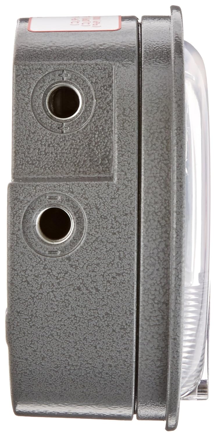

    Just bought a magnehelic gauge on line. Anyone know where I can get adapters for it?

    Auto parts store like NAPA should have what you need or maybe a Graingers store.
    I used 1/8 NPT pipe to 1/8 tube fittings and 1/8 tubing. But depends on what fittings your gauge requires.

    Yeah... I was looking at 1/8 brass tubing.

    I think I got poly tubing which is more plyable. Fittings were brass hose barbed to match the tubing. I guess you could use vacuum tubing too?

    Home Depot has a wide variety of brass fittings......Lowe's too

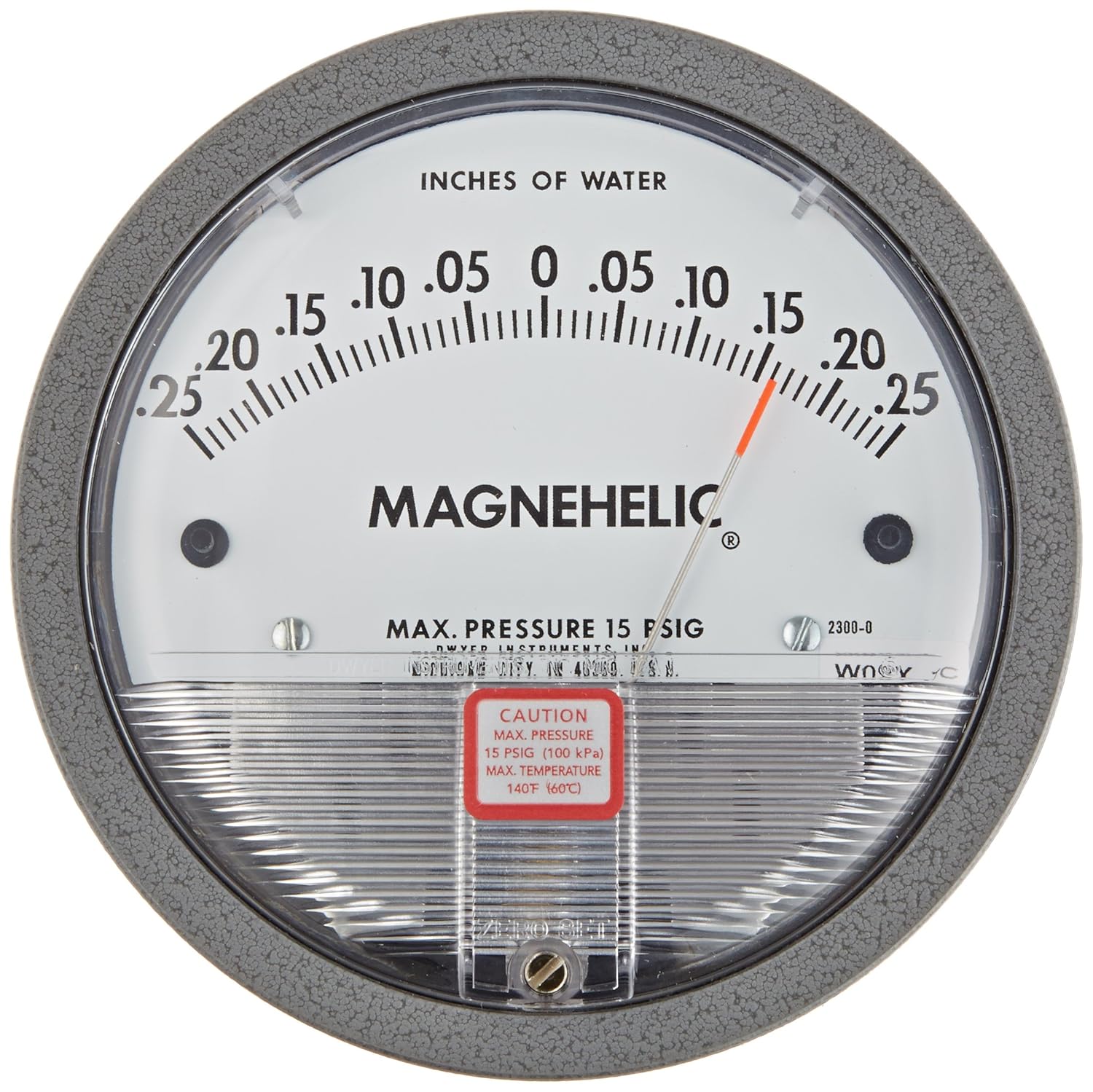

    a bit different from my Magnahelic....and maybe unsuitable. Mine measures down to -.50 inches....the one pictured measures down to -.25. For instance, for Harman's we like to read over -.25 for all draft readings (hi draft for most units should be at least -.40, and low draft between -.35 and-.45 inches). Given those parameters, a meter which will only measure down to -.25 inches wouldn't appear to be sufficient). I got a digital gauge awhile ago, which is pretty nice, reading even higher (or lower) limits.

    The manual for my enviro sets the draft at .10 to .12. That's why I bought this one.

    You have to get a bracket for it. There is a screw in the front that zero's it out.

    Still trying to find something small enough to fit into the 1/8 in hole in my stove.

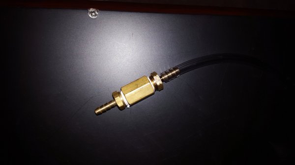

    Mine doesn't measure negative...but here's my fitting for the stove.
