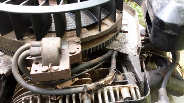

  18. HDRock
    17,249
    60,361
    Well so far so good put a new coil on and it has not failed to start.
    Put in some new plugs while I was at it
    Here is the old coil and it seems like the mice had a little lunch on the wire
    Horkn, chance04 and concretegrazer like this.
  19. Horkn
    28,549
    161,538
    Good deal!
    That's why I had to replace my coil on my lawn tractor. Mice chewed the plug wire right at the coil. No way to fix it.
    rookie1 and HDRock like this.
