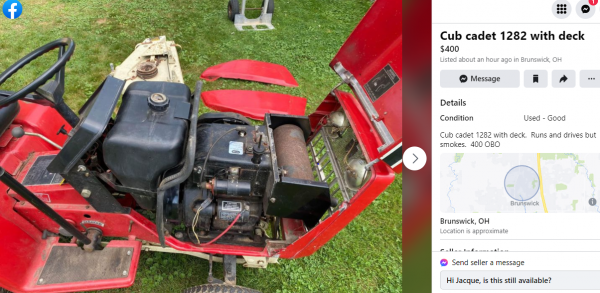

    I'd stay away from the elcheapo "tractors" that have the sealed belt drive transaxles...completely disposable. Any of the old Cub Cadets would work...the ones with the heavy duty cast iron transaxle and "shaft drive"...70's to maybe early/mid 80's (longer?) vintage...and anything in the say 14 HP (12?) and up range will do what you want...those older cubs always had a nice HD cast iron front axle and heavy steel frame too...dang things are all over the place, around here at least!
  12. brenndatomu
    23,460
    150,765
    Here's one that just popped up locally...there are tons of them, they are usually cheap, and worth fixing if they need something...
    (Not sure why the words and the pic posted separately?!) :hair:
