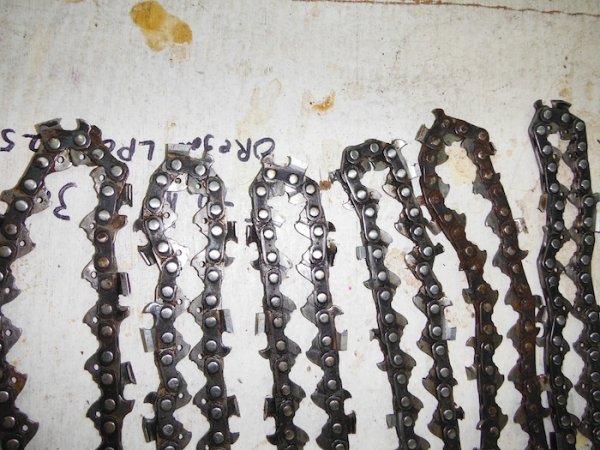

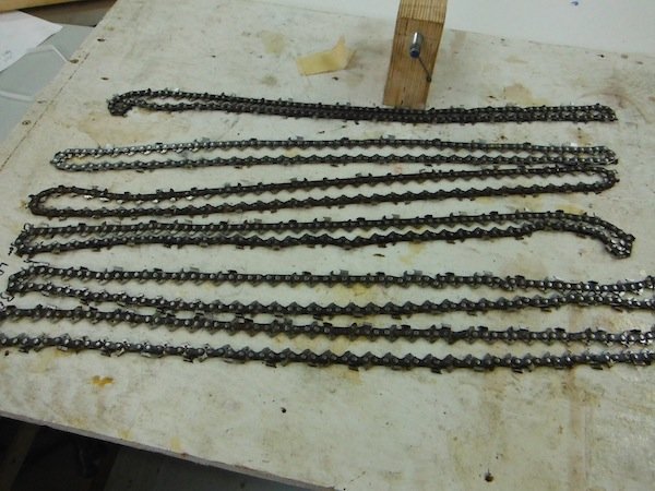

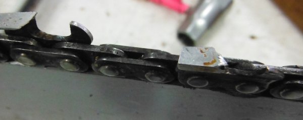

  14. bogydave
    Rainy day project & it's raining
    Cleaned them up a bit in some old 2 cycle gas. Threw one in the trash.

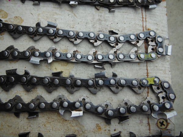

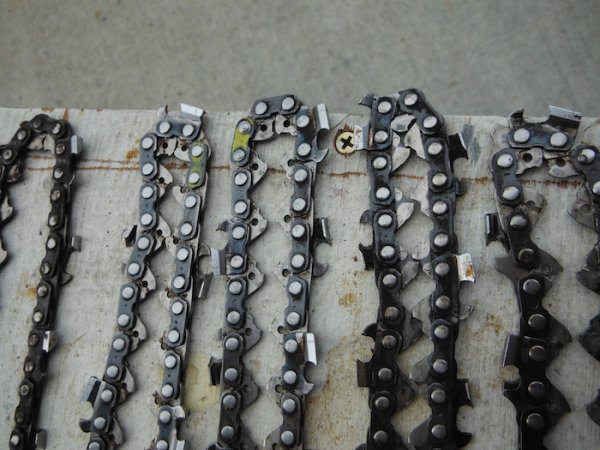

    Skip had 24 cutters, 2 links between , full comp has 36 with 1 link between
    One was rocked on the right side. , had to file 50% to get it out, measure cutter length & filed them all the same length
    2 were pretty much new, but I touched them up with a file,

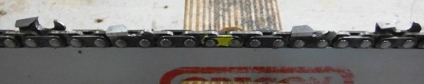

    one of the new ones looks home made, missing a cutter at the splice link
    Should be a cutter where the yellow link is
    2 pretty much new, 2 about 1/2
    & a skip.

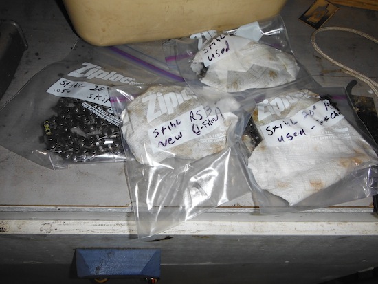

    Left one of the new ones on the saw, sharp & ready to go, the one missing a cutter.
    Ready to go. I sprayed with WD , wrapped in a paper towel & put in a zip lock.
    Stored with the other chains, got 15+ years worth of chains , cutting, 8 to 9 cord per year.

    Wow!!! You filed a chain back 50% by hand!!!! More patience than me!! I would of just got that one xutter close to right and not gone back so far if only one cutter was rocked?
    I think some chins that the yellow link falls close there isnt a cutter. I have seen some stihl chain missing a cutter or either have two on the same side near that link.

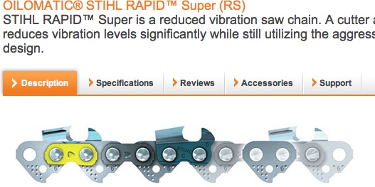

    Any loop with a link count that doesn't divide by 4 evenly will have an anomaly in the pattern.

    Looks like 2 or 3 of the chains can be square filed. Great for clean wood!

    Not sure what you mean ?
    2 of the chains didn't have a cutter missing. (the skip was missing a lot :) )
    The RS I bought from the Stihl shop a few years ago didn't skimp on a cutter.
    All the 72 LGX & LPX I have , have all 36 cutters.
    Not seeing the logic ?

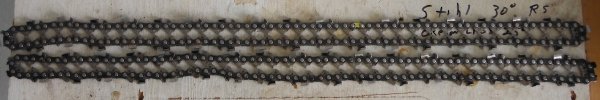

    Pic = Both Stihl RS, 3/8, .050, 72 DL.: Top one is the one missing a cutter (only has 35) .. bottom one has all 36 cutters :
    Stihl web site has a cutter on the yellow link, why not this chain ? ? :
    all the teeth on the right side were rocked, that was the worst

    Ann the whole side was rocked. Thats different.
    You could of used it as your circle cutting chain:rofl: :lol:
