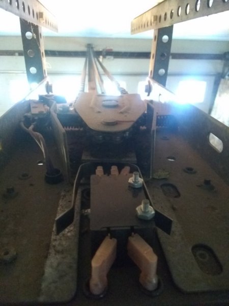

    Here is an internet photo of the top of the unit...mine is pretty much exactly like this one, except the open stop switch and the close stop switch is made into one switch on mine, instead of two separate switches like is shown here...I need to see if I can fine a good electrical schematic for it, but I wonder if this switch/internal contacts failing could cause this problem?

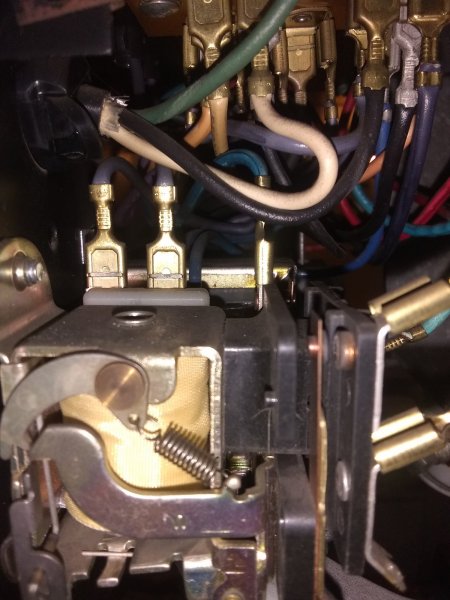

    I think I'm going to clean these contacts (on the right) I'm wondering if one of them kinda/sorta welded for a minute if that could cause this issue...of course the stupid thing won't act up for me now...it'll wait until the middle of the night to go berserk! :hair:
    Think I'm going to replace the motor capacitor too, I heard it hissing a bit after a few trips of up/down...it still looks and smells fine though.
    Here is my open/close switch.

    Probably that pitting on those contacts ain’t doing you no favors.

    Switches are NO, and already unhooked at the opener, so that eliminates mouse chewed wiring too.

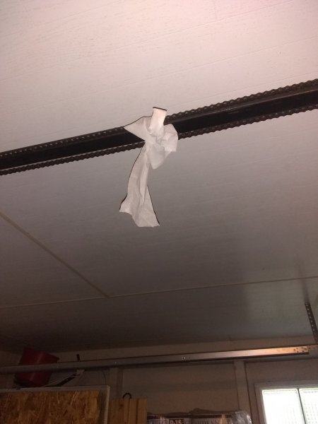

    Well, I cleaned those contacts up, we'll see what happens...I have my "bear trap" set for the night...it hasn't stayed put the last 2 nights...I was trying to figure out how to tell if it activates during the night, especially since I have the door uncoupled now...no way to tell if it did anything if it ends up back in the down position by morning...so I wrapped some TP around the track/chain...if it moves the TP will be torn up.
    Those contacts cleaned up pretty well, but I think I'm going to try and get a new relay assembly for it...the more I think about it, the more I think these contacts lightly welding could cause this issue. I couldn't find a make/model/number on the relay, so no idea if I can find a new one or not ...probably NLA from the OEM if I had to guess...never seen one quite like that before, so I dunno...

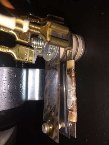

    This light switch is interesting...bi-metallic strip with a coil on it...I think after the light is on for a while, the coil heats up and opens the contacts up...at that point then I think the contacts on the other side make and keep the coil energized to hold it open/light off...when you hit the door button it energizes a relay that opens the "holding coil" and allows the light circuit to close again, process starts all over again. I'm not sure, but I wonder if the draw of the light actually helps to heat the strip up...in other words a 100W bulb would turn out faster than a 60W would...and a 15W LED may not turn it off at all? I dunno, just guessing since I don't have an electrical schematic yet.

    Solenoid/relay, yeah...it's that assembly in the first picture of post 6, that's the only relay, otherwise its the motor, a cap, some limit switches, and a 24V transformer...oh, and the "light switch"...that's about all there is to it.
