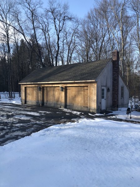

    D43672E6-12A0-44C7-B06A-D9D0ECD2132F.jpeg If you’re thinking 28’x28’, consider 24’x36’. It gets you a third bay for not much more money. The salt box roof is all 2x8’s, but still storage above the collar ties. Not standing headroom, but a good amount of area to put stuff you don’t use everyday.
    2x4 walls, no insulation but , of course, a wood stove!

    Thanks for the compliments, but I’m getting too old to have built it myself. 10 years ago, sure. It has a 4’ frost wall on footings and a slab inside. I wanted more headroom above but there is a huge difference in price between a 2x8 and a 2x10, or 2x12, 20’ long, at least here in Ct. especially when you need about 40 of them. But with the salt box design you don’t need lumber 24’ long. I still have a clear span lower floor.
    I park a full size pickup and a normal size car in there and have plenty of room for a workbench, standing tools , wood stove and a canoe I’m working on.
    Price depends on options and location of course . Digging and fill is expensive, electical, doors, chimney, etc. add up. Siding an roofing are options, so I hesitate to give a price. Get some sketches and a lumber list and you’ll be surprised at the variations in quotes.
    If you’re in Maine, face it south if you can. Very nice after snows.
    I built 3 sheds and the garage so far and I always wished I built them a little bigger!
    T.Jeff Veal and Chaz like this.

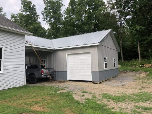

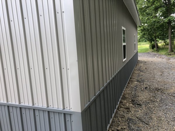

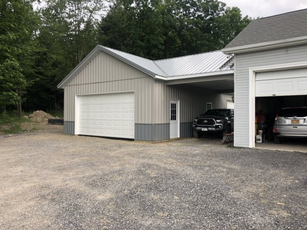

    Go about twice the size you think you need or at least build it so you can add on to it.
    I had this built last year.
    B68B7707-8BBB-4EC5-BC2E-A7DB9ED0625A.jpeg 25ABA0E5-837E-467C-A360-E3F51D137B6D.jpeg
