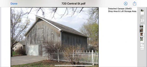

    Too cold to go take pictures so I’ll see what I can find. Our barn garage was built in 97 but looks much older. Board and batten exterior, shakes, and a white eves. It has an I beam going right down the center to help carry second floor. I believe it’s 28’ wide and 42’ deep but I may be a bit off. The roof is trusses with 2x8 joists for second floor floor and main level ceiling. Second floor is great for storage currently with a dream of a more useable space sometime down the road as a guest area/gathering spot.

    jtstromsburg this is what I had in mind! I like the board and batten. How much head room you have upstairs?

    I’ll get some pictures later but the sidewalks carry the roof trusses and there’s about 48” or more and trusses scissor to middle with a solid 10’ there. So there’s 16’ or better wise with 6’ of headroom.

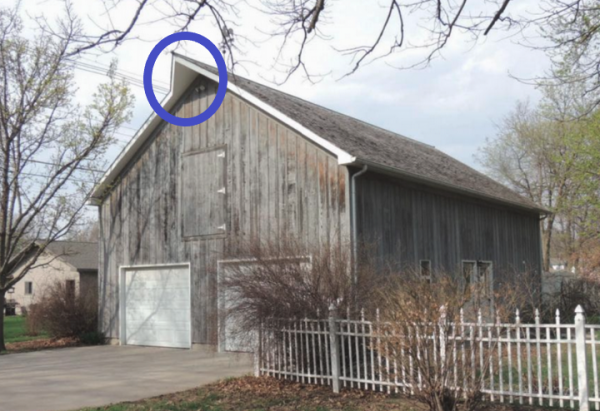

    What is the purpose of this on a barn? Does it lend some strength to the roof or building? The overhang doesn't see to protect anything. Or is it just looks. I guess I see them around, and your picture made be curious.

    SloMoJoe that peak in olden times carried a pulley to lift hay into top of barn

    Called a widow’s peak or crows beak roof.

    Yup like was said above. This was built to look old and is even stained in a weathered grey so it looks, well, old. Needs stained this year again.
    It has a full stairwell to the second floor and one wall with a door opening roughed in on one side of said stairway. The other side of the stairs is the garage wall so all is insulted and the shop side has a 1/2 bath and hose bib with a floor drain and plastic walls in the corner. It was -29f this morning but supposed to only be -7 tonight so I should get more pictures tomorrow.

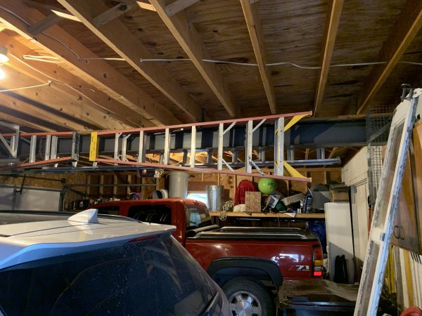

    Totally forgot about this till just now. 70 here today, for a couple hours. Yards a mess and so’s the inside, but here’s some more pictures of our barn/garage/shop/catch-all. Sidewalls are 52” where the trusses set and the height in the center is about 9’-2”. You can see the main beam in the garage and it’s wrapped in the shop side. Floor joists are 2x8 spanning about 14’. We really like enjoy it but boy does it need a good spring clean and purge.

    96,676
    Seems a large beam would have worked well in place of the posts.
