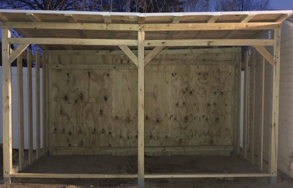

    This is a picture of my shed just completed with the vertical beams on the sides leaving plenty of room for wind.
