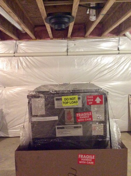

    My Kuuma Vapor Fire 100 arrived today. I am so excited to start working on the install. It’s going to be a beast just to get off the pallet. More pictures to come as the install progresses.

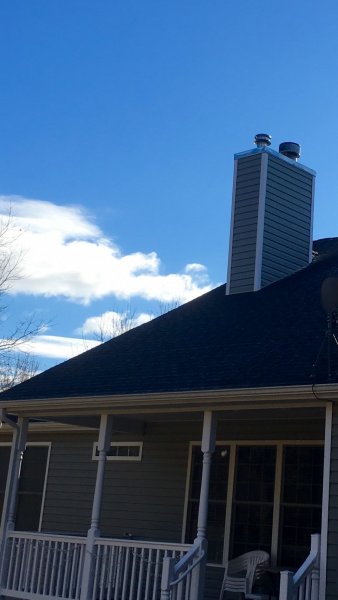

    Got the Kumma installed and all the duct work insulated yesterday. Currently 19 degrees outside with the wind blowing and the house is sitting at a comfortable and even 70 degrees. I think this furnace is going to be a great addition!
    Checked out the chimney and had visible smoke when the stove was first lit. After a few minutes you could not even tell we were burning wood.
