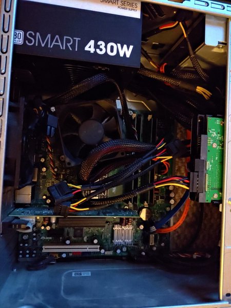

    So our ~10 old dell pc just stopped working the other day. The dreaded Dell Amber light.
    There's really 2 possibilities. Motherboard shot, or power supply shot.
    Well I replaced the PS about 5 years ago. Those are cheap. Under $40.
    So I got a new one today. I installed it,
    and the same yellow light.
    I guess it's motherboard time.
    Hopefully that isn't too much.
    Any thoughts on this Grizzly Adam ? Anyone else?
    I will try a new cr2032 watch battery before I take anything else apart.
    I'm a hack at this stuff, but I've successfully fixed and even built my own entire PC's.
    It's really just screwing and connecting stuff together.

    Ok, after the motherboard went all over Wisconsin due to some usps issue, it arrived on Thursday. I swapped the motherboard over today, and same thing. Grrrr.
    I'll try to swap the power supplys over and see if that does it. If not. I might be building a PC. I've already got a power supply.
