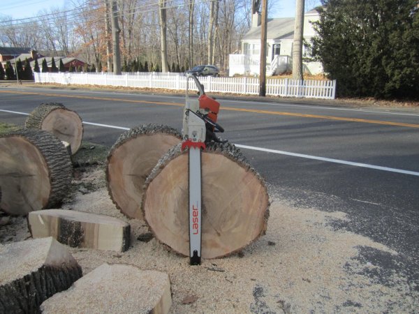

    I'd prefer full skip with that bar and saw combo, but you may be able to get by with full comp occasionally 20201109_144050-1cropped.jpg . That said, I'd be more worried about getting enough oil to lube that bar. Not ideal for the standard oiler. I put a high output oiler in my 461 and run full skip if I'm using the 36" bar.

    Thanks. Again, seldom used. Never really liked the Laser bar.
    Love those dawgs MB! :thumbs: IMG_1684.JPG

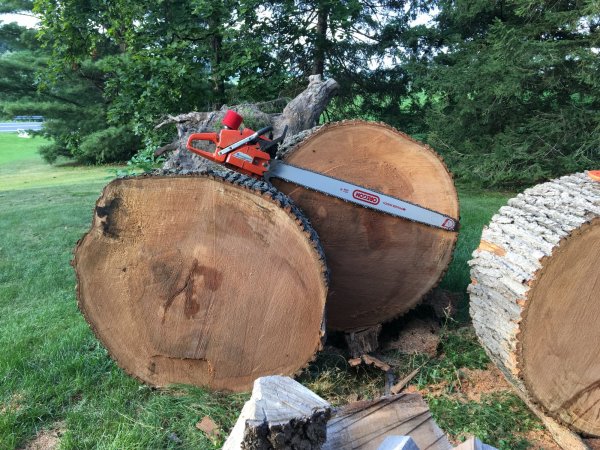

    I ran 28" FC with my 361 on some big sugar maple last Summer and it handled it fine. Ill have to check and see if the oiler is turned all the way up.

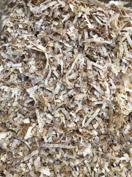

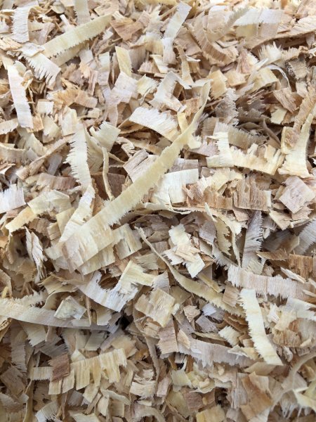

    Just shooting from the hip here.. mainly personal preference. Watch some of these guys cutting aussie hardwoods and they get dusty chip. Full comp probably not an issue. Pulling long chain through a big conifer creates larger chips that can clog. When you square file/grind it comes out like this:
    64CB154C-909E-47A5-A564-77BA0FCF9199.jpeg A047B3E7-124D-4341-B6FB-E452BC9ECDD8.jpeg
    Carrying that out of a 36” (or so) and up kerf is the challenge. Different species create different challenges. Oak doesn’t ribbon like that.

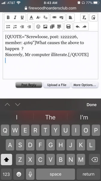

    What causes the above to happen ?

    When you replied, you typed inside the QUOTE which puts it in my quote box.[/QUOTE]
    Next time make sure to start where the blue line is in my pic.
