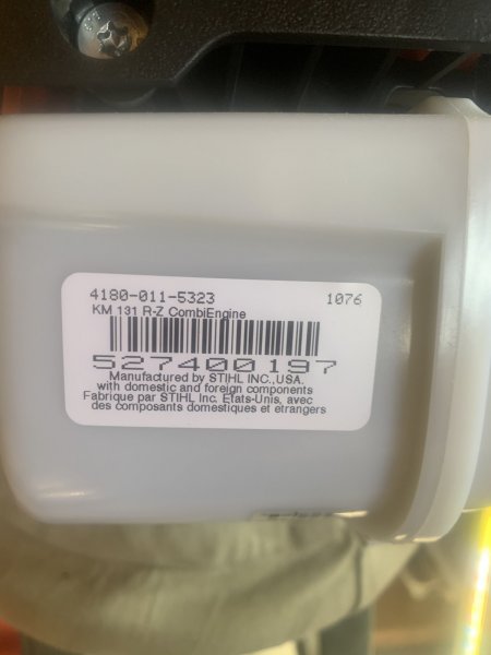

  7. Canadian border VT
    18,271
    119,744
    Yes just got a split shaft 2 stroke power head last month as I have chain saw, tiller and other attachments

  9. Canadian border VT
    18,271
    119,744
    Comes in 3 sizes. 91 110. 131. I got biggest because rototiller for just string trimmer too much power.
    saw blade attachment will drop 3” maple saplings
