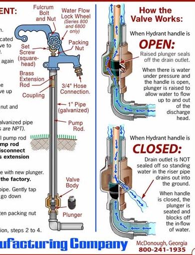

    I'm sure you understand the philosophy of this hydrant. When you shut it off the water in the pipe drains through a weephole into the ground. If the hose is left on and in the trough, it can create a siphon and empty the trough back through the weephole. Thus, if you had a siphon going on, you have a large block of ice at the base of your hydrant underground that is frozen solid. I have had good luck with a large diameter piece of pvc (mine is green if that matters) and I have a metal shield of a heat lamp screwed to the one end. I slip this contraption over the hydrant (pipe has to meet the ground) Turn on the heat lamp and leave for at least 24 hours in mild weather. It will thaw, but it will take a while. I had a hard time convincing my girls to stop turning on, turning off countless times in severe cold weather. Turn on and use the shut off at end of hose then when done, shut off and disconnect hose, so only draining the hydrant once per chore time.

    I'm talking a small fire. You could even use charcoal briquettes started elsewhere and dumped on the ground around the hydrant. The heat would thaw both the ground and the pipe - especially given the comments in the previous post about the weep hole.

    But there are rubber washers you don't want to melt.
