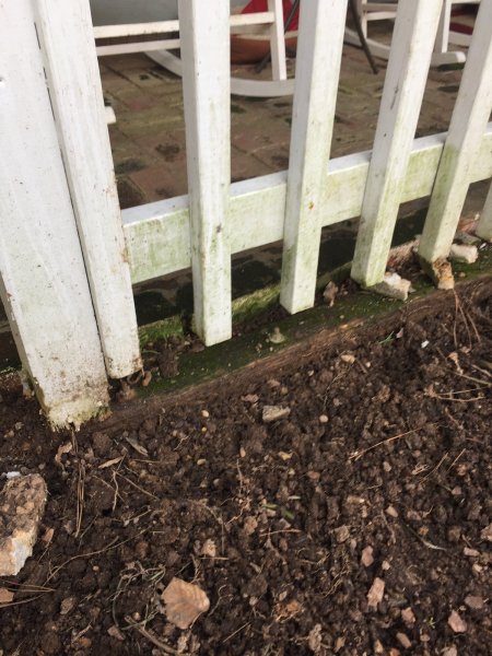

    This front porch was added on the house 20 yrs ago. Originally there was a slab at a lower grade that had a step down off the “sidewalk to nowhere”
    A 2x4 was bolted to the slab and posts nailed on top. After that the homeowners used recycled handmade bricks on a peastone bed and mortar it’s really uneven lots of toe kickers and the brick grows algae constantly making slip hazard.
    On top of this they sculpted mortar around the 4x4 posts which has led to moisture retention and rot- not 100% sure they are even PT.
    So I’m looking at options of tearing it all out temporarily supports on the roof and adding a sailor course of pavers on the edge bedded in mortar/concrete then replacing rotten posts with stand-off anchors. Then redo the sidewalk with pavers.

    Here’s another picture of the post to 2x4 connection with patio grade.
    I think it would look cleaner with pavers bedded on mortar to support the posts vs concrete perimeter.
    Main concern would be paver base compacting over time and leaving a lip where it transitions to mortar bedded.
