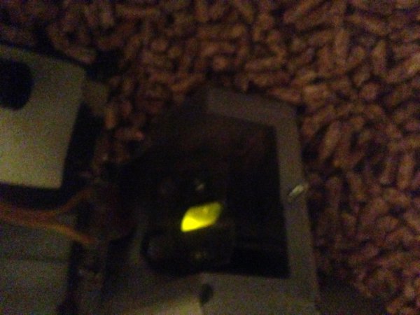

    The best test is to shine a flash light up the auger chute. If you can see the light clearly thru the lens it is clean and the stove will run normally.

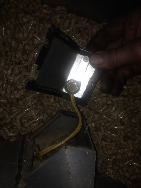

    Pic 1 - Photo Eye bolted to inside cover next to auger chute. Remove two nuts from the cover and turn it over.

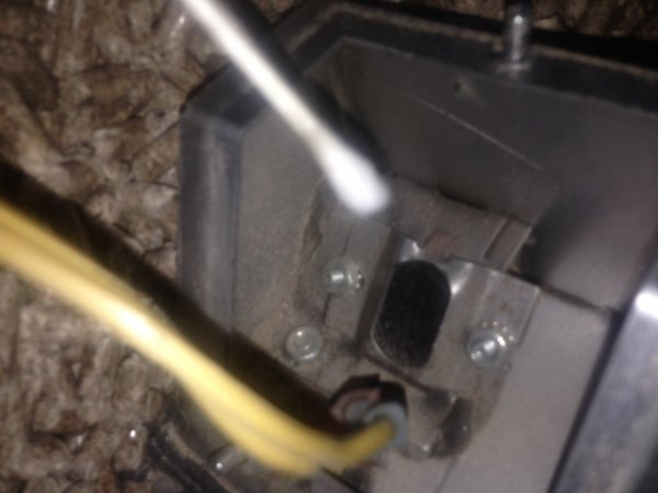

    Pic 2 - Wipe dust off hopper side of lens with a cue tip and then remove both nuts to remove lens and support bracket.
    Pic 3 - Light shines up auger drop chute and shows clean lens!

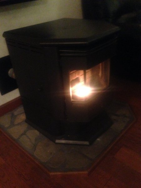

    Pic 4 - Stove runs great!
