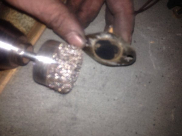

    Hello
    When the snap disc senses the exhaust temp of usually 120 deg F on most stoves or 110 Deg F on AES Magnum and Country Flame stoves the convection / room blower turns on. If the disc is an airstream mount then Not if it is real dirty from exhaust ash!
    See before and after clean pics below, click to enlarge:

    Harman, Quadrafire, and Heatilators do not have such a disk.
    Eric
  4. don2222
    don2222
    Nov 10, 2013
    3,367
    4,687
    Salem NH
    Nor does Englander and Pelpro has a surface mound that does not get dirty. :)
    However Enviro, Magnum, Country Flame, Lopi, Avalon and a few others do. :)
