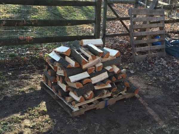

    I know I will be told to check around on the forum for the answer...but I constantly check. I like the opinions/thoughts currently...Some say don't cover and that when it does get wet, it drys quickly, some say cover it but just the top.....I let wood sit in my garage for two years with no sun or circulation and it was still wet when I used it. I also let few pallets sit out with wood without a cover at all and even thru summer, it was still wet and sizzled in the Winter when I used it. I thought about making a "Pallet House" with 3 sides and the one side open to protect it more from rain and wet....Thoughts and input and opinions please.

    I would leave this sitting out exposed to the elements. A sunny and windy spot would give you the best results. Maybe top cover in the fall or cover in clear plastic for a solar kiln effect.

    Beautiful stacks man :thumbs::thumbs:
