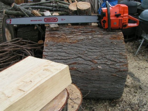

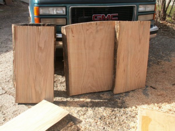

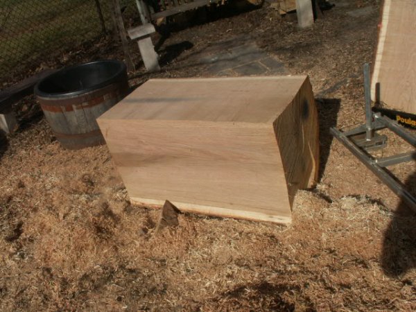

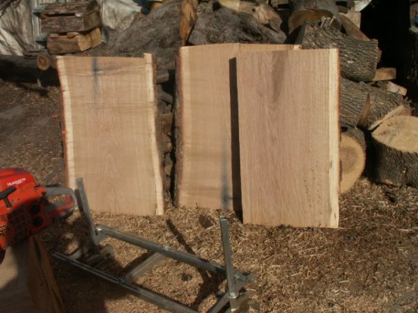

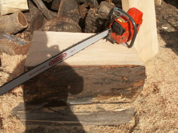

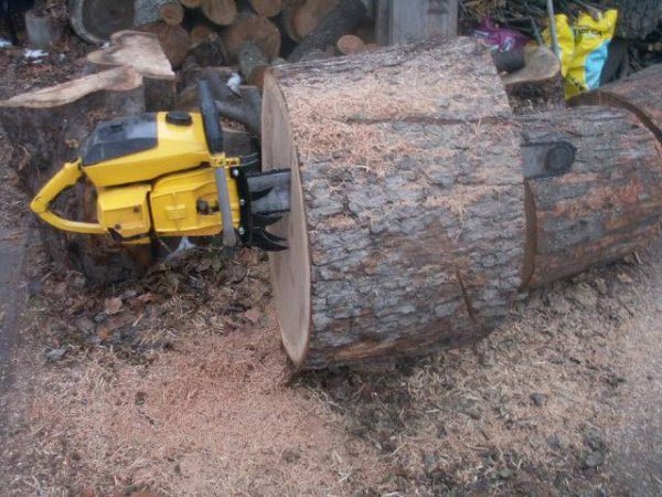

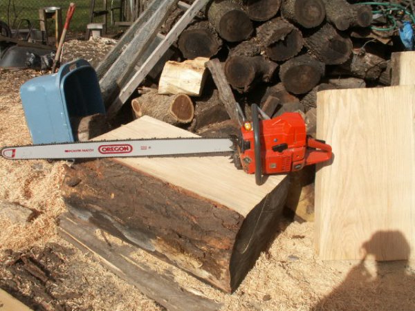

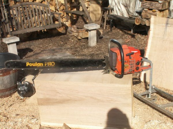

    With years of practice,a sharp chain & steady hands (keep your feet planted only move your arms & shoulders) I can get within a 1/4" of being parallel or square on short pieces/blocks/wider slabs up to 4 feet long.I don't set up the Alaskan mill except for longer stuff or when I need total accuracy from the beginning.Since the stuff is either roughed out bowl blanks or will be planed/sanded/shaped/run through the big bandsaw at a later time once thoroughly dried.

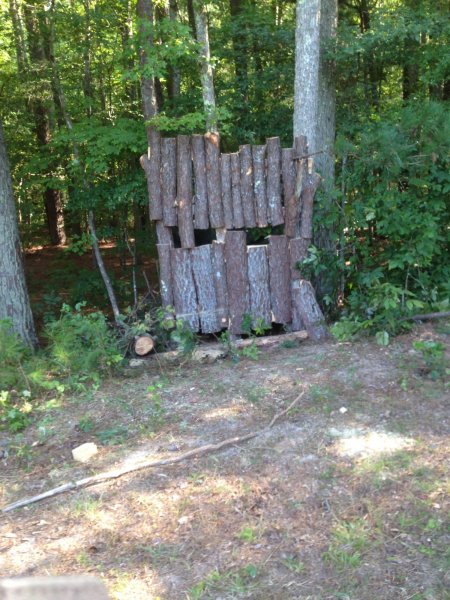

    The blind came out pretty good. I used the bark-on slabs to face it so it blends in pretty well. The slabs are about 3 inches thick, so way overbuilt. Here it is before we put the shade cloth around the back. With the shade cloth, it is pretty hard to see inside. From a distance, it is fairly hard to see. But as my son points out, it doesn't have to be hidden, they just have to be used to it.
    Judging by the fact that there are 6 deer feeding down there right now, I think it should be OK. Then there is the buck eating near the pond and the three does working on the duck feed.
    The three are gone and a mother/fawn pair have come in.
    I have no idea why I'm even thinking about planting a food plot. The weed mix we already have must be pretty good.
