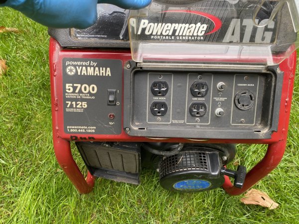

    I was mowing yesterday in VT when our neighbor drove by. We both stopped and chatted. My wife came out to join the conversation. My wife commented that he had a good amount of stuff in the pickup bed.
    “You guys want a generator?” Sure! He and I unload the Powermate unit from his truck. He then says “You want this other one too?” And pulls the cover off the Toro unit. OK! We asked him multiple times if he wanted anything for them. Nope, he had taken them from his mother’s house (which was for sale and closing soon) and he was going to have take them to another family members place to store before eventually having a yard sale in the spring. For him, this was easier. That being said, my wife and I will be getting them something; probably a gift card so he and his wife can have a nice meal out.
    He said the powermate hadn’t run in a few years, the Toro ran last year. I checked the oil on the Powermate, pulled the air box cover off, hit it with some cheater spray and it’ll run for a bit on full choke. I’ll most likely pull the carb and clean. I’m going to put some gas in the Toro and try starting that today.
    I went online last night and found specs for both engines. I plan on oil and plug changes on both along with air filters. The Powermate has a Yamaha engine that should be pretty reliable; unit is a 2007. The Toro is a neat older unit from the 1980’s with a Suzuki engine.

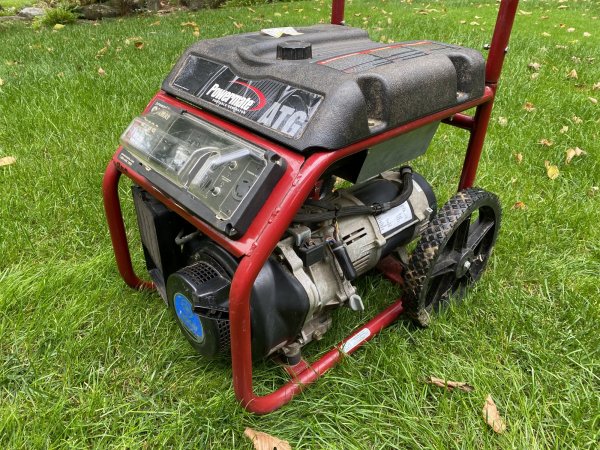

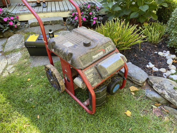

    Had a good day yesterday working on the generators.

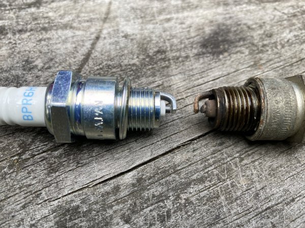

    As suspected, the Powermate had fuel in the oil. More than a quart of oil came out when draining the oil and it had a gasoline smell to it. Glad that got changed! Filled with 10w-30 synthetic. This unit was really easy to work on, easily accessible oil drain plug and very simple to get to the spark plug.
    The plug didn’t look bad. I’ll keep it as a spare.
    Cleaned up nicely! Just need to work more on getting the grime out of the texture on the fuel tank. 5C87793E-B62D-4B88-B7C1-FA5E0728B3AB.jpeg

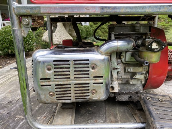

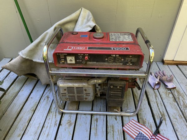

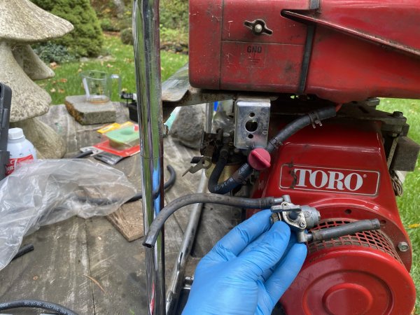

    On to the Toro! I love the chrome exhaust heat shield. They don’t make them like this anymore.

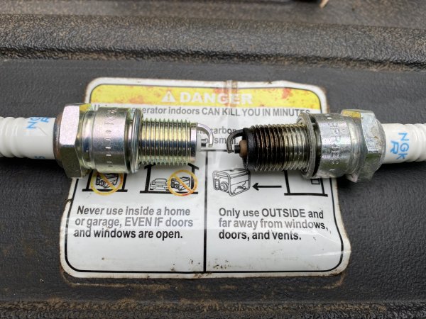

    The plug….yeah, that needed to be replaced! I’m surprised it ran smoothly given how crusty it was! Not saving this one as a spare…

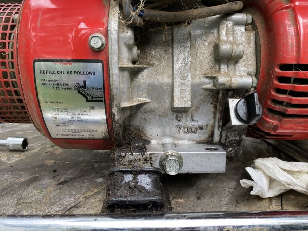

    Thank you engineers for the nice big label regarding oil capacity (in multiple units!), weights based on operating temperature and change interval. And the oil capacity cast into the block is a nice touch too. Drained the oil oil and filled with 10w30 synthetic.
    I replaced the fuel lines and the shutoff. The metal shut off is non OEM and hard to move. Unfortunately, the OEM shutoff/strainer is no longer available. I used a spare new plastic shutoff I had in my parts collection. I need to to get new clamps as 1/4” ones are too big and the OEM ones are too small for the line I’m using.

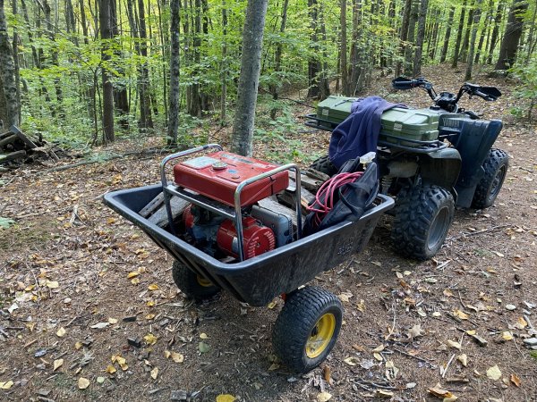

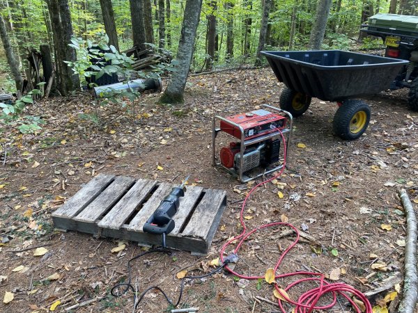

    I gave it a good test up back. Hooked up the Swazall and cut up some old pallets. Worked great! The unit was surging for awhile. Last week, it smoothed out rather quickly; a minute or two of running. Yesterday, it surged for a good 10 minutes when I ran it after the working on it. I brought it up back an hour or two later and same thing. But it eventually settled out. I dumped a good amount t of seafoam in the tank and hopefully that helps clear thing out.
    This unit is great for running tools and it fairly portable in the trailer behind the quad. It’ll come in handy for cutting up old pallets and having to use when I’m wrenching on the snowmobiles in the upper shed.

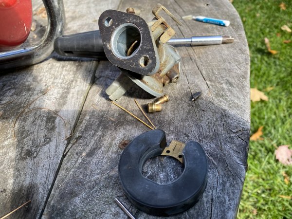

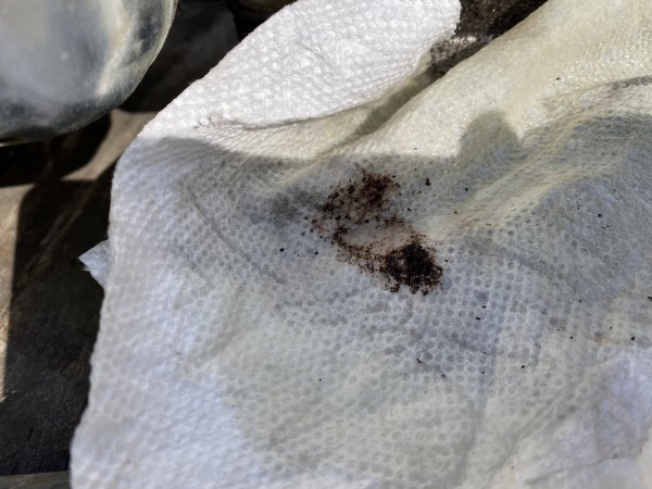

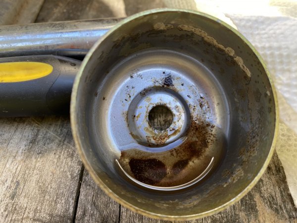

    Took the carb apart yesterday.

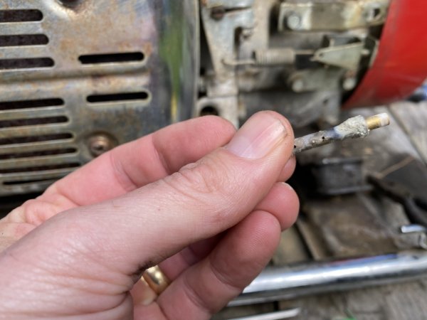

    Guess there was a little rust in the gas tank!
    D18CE1F0-0D84-462C-826B-4ABF3E578CBA.jpeg 7323BBDC-4631-4BA2-BC4A-5AD9319AB951.jpeg

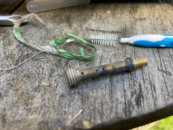

    Found the cause of the surging. It was a challenge to get that main jet out of the carb with that build up. I’m just happy I was able to get it unseated from the carb body; those sometimes seize up after time.
    All cleaned up.
    Carb is fairly simple; it’s a Mikuni and setup similar to a snowmobile/ATV carb.
    After I was done, I turned on the gas and a the carb overflowed. Pulled it apart and adjusted the tang on the float slightly. Same results. Ugh! So I fired it up to at least test it out. It runs really smoothly now. And after I shut it off, the overflow issue went away? Very odd. I’ll keep and eye on it.

  18. The Wood Wolverine
    17,971
    114,250
    Very nice of your neighbor. :handshake:
    Is the rubber tip on that float needle hard/firm? If it isn't/wasn't seating perfect, the seal could be incomplete. I'm a fan of Seafoam, I'd be running a dose or 2 through it. :yes: With that tank crust, might be a bit before you get it all settled.
    HoneyFuzz and Skier76 like this.
  19. Skier76
    Skier76
    Dec 27, 2014
    2,813
    15,186
    CT and SoVT
    Very good point on that needle tip. I should possibly see if I can source a newer one just in case.
    HoneyFuzz likes this.
  20. brenndatomu
    23,510
    151,193
    Typical Mikuni IME...they'll all do it under the right circumstances, but Mikuni just seems prone.
