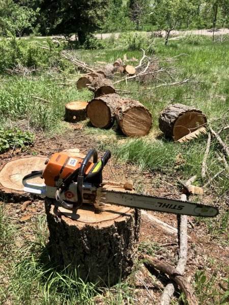

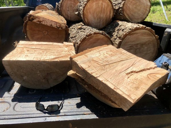

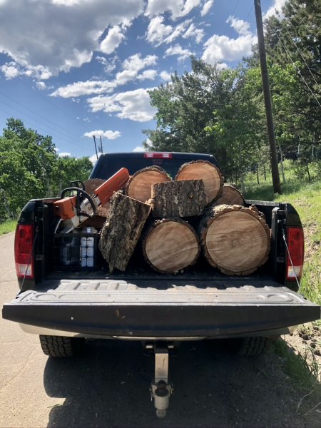

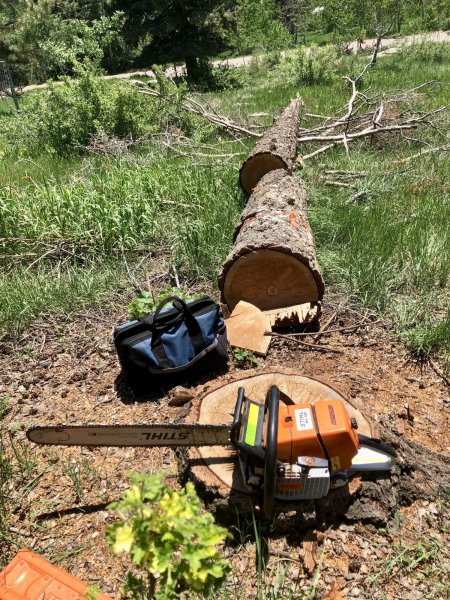

    I found a large Douglas Fir for free on Nextdoor today. The lady who owned the property said the power company cut it down. It had been standing dead for over a year. The power company was worried that it would fall on her power lines. She lives in "town" about 20 minutes from me. So, I stopped on my way home from work and cut it up. Really solid, straight, heavy, wood. I even had to noodle a round to get it into the truck. I've never noodled a log before (It's not pretty - take it easy on me). That round probably weighed 200+ pounds.
    It was HOT outside too!! It hit about 80 degrees today. I'm not used to that kind of heat!!
    Hope everyone is doing well!
    -Cash

    You need some ramps. Work smarter.....

    I have some. The lady said the tree wasn't "very big." So I didn't bring them. She undersold the job.

    So about this noodling...was the round standing up, or laying on its side? The saw marks are inconclusive...:D

    Standing up. It was on asphalt. If it was on it's side it would have rolled.

    That’ll yield pretty small chips if your saw was parallel to the ground. In my humble opinion better to noodle on its side. Throw a wedge under each side. Then you get the the long noodles.

    Ok, that's what I was thinking...noodling is done with the round on it's side, cutting with the grain...makes long noodles instead of chips like when you buck. It goes much faster than cutting down through across the grain...just need to cut a wedge to stop the roll...:handshake:

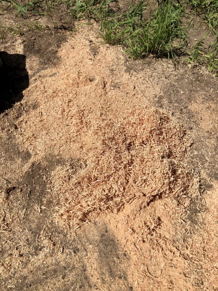

    brenndatomu I did figure that out eventually. The round was so heavy, it was just rolling over my wedges initially. So, I grabbed some big chunks of bark to eventually stabilize it on its side to finish the job. You can see the small chips - transitioning to noodles, when I flipped it over.

    That explains the confusing saw marks...

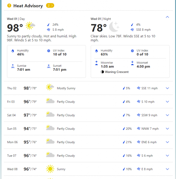

    Nice score, looks like it is pretty dry as well? I don't see much fir so just guessing. Oh for 80 degrees, September in Texas:

    Brutal! And yes, the tree is dry and ready to burn this winter:thumbs:
    I can’t believe it’s almost 80 at night there! We are in the 30’s and 40’s here at night already.

    Looks like you got grits instead of noodles for a while there!
