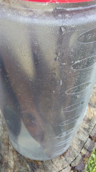

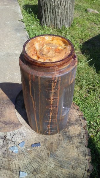

    Soak it in white vinegar for a few hours if you are looking for a manufacturers mark
    It'll take it to bare metal.

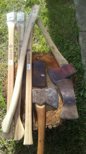

    Here's one day of white vinegar on Kelly's axe heads 20170528_180010.jpg 20170529_185240.jpg 20170531_164020.jpg 20170531_164502.jpg 20170601_200903.jpg I rehung a bunch last year.
