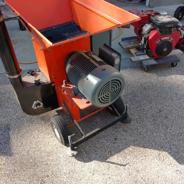

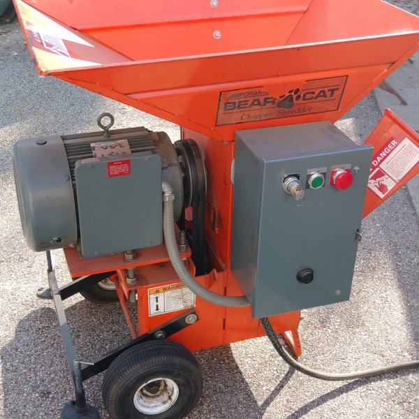

    When I got the pto chipper I removed the 8hp Breaks & Scatters and put on a 10hp 3450 220 single phase motor.
    3R enclosure with NEMA 4 controls.
    I was making room in the garage and found it where it sat at least 10 years.
    Started on the 1st push, I must have drained the electrons before storage.

    That’s a cool conversion! How’s it perform vs the prior gasoline engine?

    Much, much better. Once the engine would bog it went downhill quickly.
    The motor on the other hand doubles down and pulls through.

    The Briggs did indeed work pretty hard on those, especially with that blower kit. The bigger Honda engine options were much, much better. Can you believe they offered that same chipper with a 5HP Briggs and a lighter flywheel? Almost useless as a chipper. That said, those are pretty much the best small chipper/shredder unit I've ever come across. If you can start/power that motor, I don't see it stopping for much.

    Yeah it worked really hard for sure. Frequently it would suck in too big of a bite and you would stand there fingers crossed, butt cheeks clenched as you prayed for the struggling briggs to not stall!
    Once it stalled you had the fun job of blindly reaching all the way into its constipated bowels and yanking , trying to rotate the clogged rotor backwards, cussing all the while.
