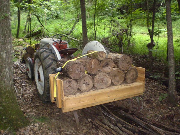

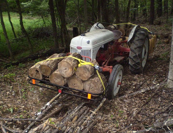

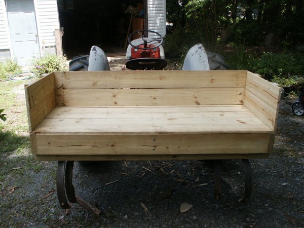

    I built one to sit on the cultivators but my sister has a carry-all frame that she said I could have. I need to see when I can get it over here as it would be better than using the cultivator. I added a Harbour Freight carrier to the front of the tractor (an old 8N Ford) so that I could add counterweight to the front of the tractor when I load the carry-all.
    Here are photos:

    Nice setup on the 8N there Kimberly. I like it.

    I like that set up!

    Thanks. The Old Girl looks a bit tired; Dad would be unhappy with me. However, I hope to get some fresh paint on her. Otherwise she runs great and still has the original six volt system and starts without any problems. Trans has a bit of an issue sometimes shifting into first but I never press it and just keep trying until she slips in.

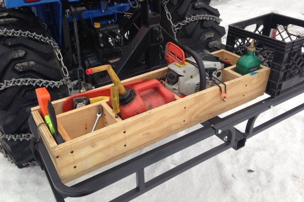

    I have this and I move logs out of the woods using my forks.

    Yes; know what you mean. I looked at getting wheel or bumper counterweights and they were expensive and with shipping .... So I decided the HF carrier mounted to the front and loaded would be the counterweight.

    I like the box for all the tools and saw; nice idea.

    I've been thinking about my JD with your set-up lately Jack Straw, and Mike's video really shows how much I could use a carry box behind me. Don't have a 3 pt hitch but a box would sure be nice. Great job MMfrompa ... :yes:
