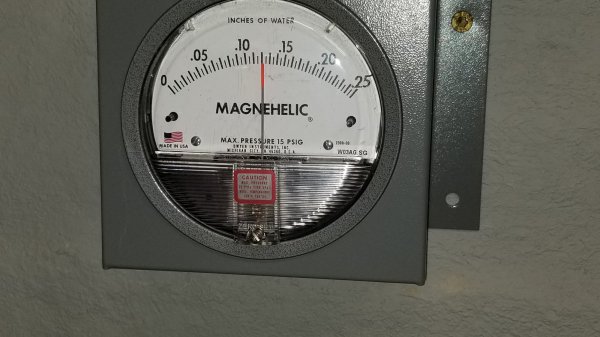

    Dealer said chimney ok. Wood is not 2 years, but meter says under 20 and usually 16 percent and less...clanks pretty well. I bought it from a dealer that said kiln dry in March 2020. I have been burning a lot and never adjust the air inlet more than half way. I usually get it up to 450 500 on stove top and then turn down half way. And this is how i leave it when i go to bed and wake up next day...let coals burn out and start a fire around 3-5 pm again. I burn with no smoke out chimney (except start up) reload or or dirty glass. I tried turning down sooner and some loads of of kiln dry and it still get it. I tried leaving ash in pan vs empty ever day. I guess time will tell.
    Where do you leave the stove top temp gauge? I think manual says corner of griddle. I found the right side of stove, the back right corner t(off the griddle) to be hotter than the left by 80 degrees or so . The stove vent output area is the definitely the hottest. Griddle take time to heat up.
    When at full burn my draft was is usually .12 and even tried a damper to adjust to .08 but still get creosote on ash pan door area.

    I’ll get a picture of my setup tonight for you. We use a flu prob for the most part and I have two stove top thermostats as well.
