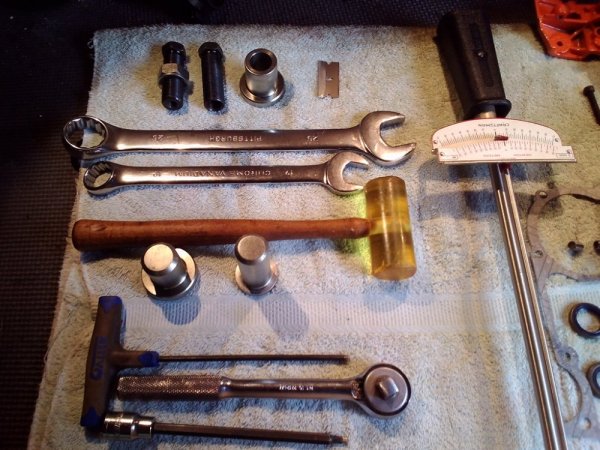

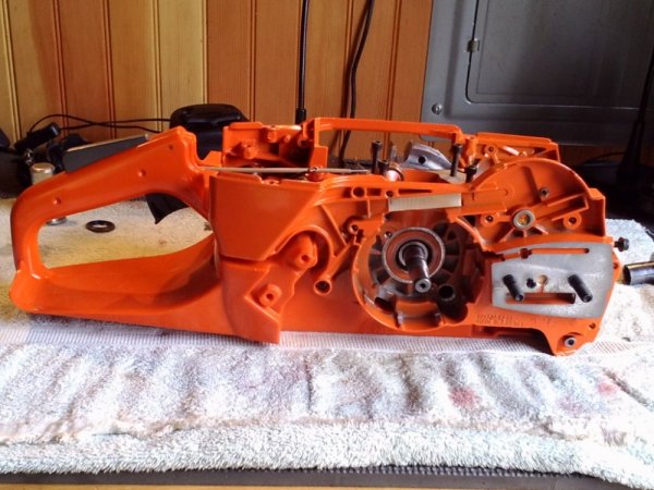

    Had a little time today, so thought I would get some basic things done on the custom Member Designed saw.
    The first picture is all the tools required to completSeal drivers and plastic mallete the lower end build.
    Left to right top to bottom:
    • Husqvarna Crankshaft Installation tool
    • Metric wrenches for crankshaft installation tool
    • Plastic mallet and seal drivers
    • 4mm T handle
    • 3/8 ratchet
    • 4mm allen socket
    • Razor bladt for trimming case gasket
    • Metric Torque wrench.

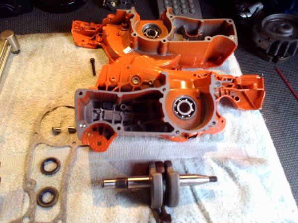

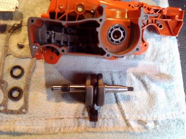

    Second picture is all the parts required top to bottom:
    • New OEM crankcase with bearings already installed note how the bearing on the flywheel side of the case sits deeper in the case than the clutch side.

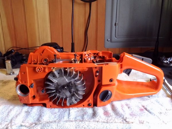

    Third picture is new OEM crankshaft, case gasket and new crankshaft seals

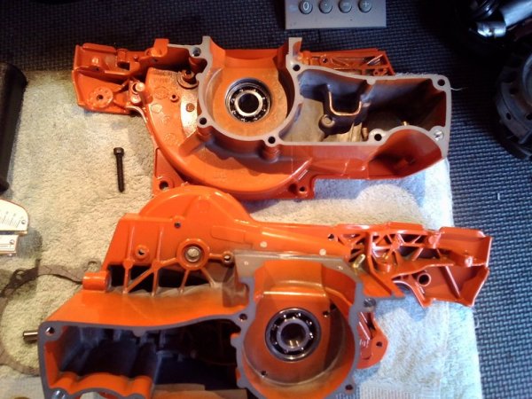

    The fourth picture is everything set out for the assembly note also the two small silver cylinders in the gasket, they are the crankcase locating pins which do two things help hold the gasket in place and insure that the case goes together square.

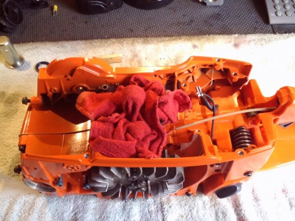

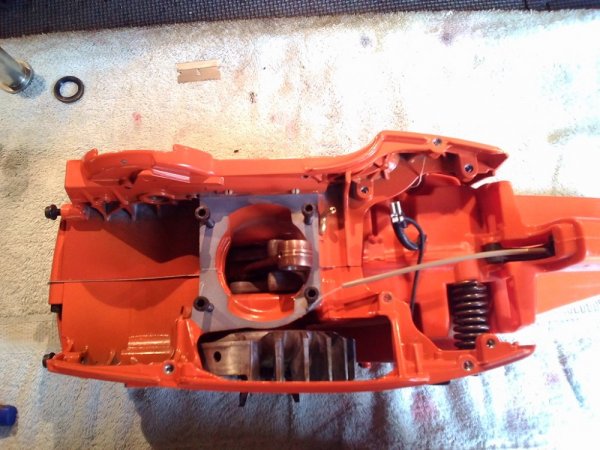

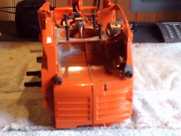

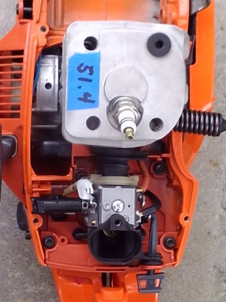

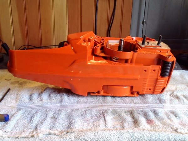

    OK, some progress made:
    Installed new crankshaft
    Buttoned up the case with new gasket and torqed case bolts
    New seal installed Flywheel side
    Installed tank/handle unit.
    That is all for now until some minor parts come in and we know what carb we will be using.

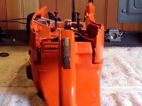

    Had a little time at the end of the day, so knife edged the transfer port entrys.

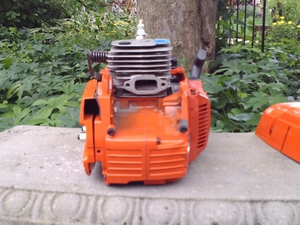

    OBTW XPW 51.4mm pistons use two rings, I will install the piston with both rings. If you and your porter want to run a single ring that is your decision. Also used a gasket because if the saw is ported then they will either nix the gasket or cut the base and besides Mdavlee likes gaskets!

    Top end is on but do not have a top handle for it yet, so can't hold it tight enough to get a good compression reading, but it is up there! Tomorrow Vac-pressure tests and set the flywheel gap and finish up the wiring.

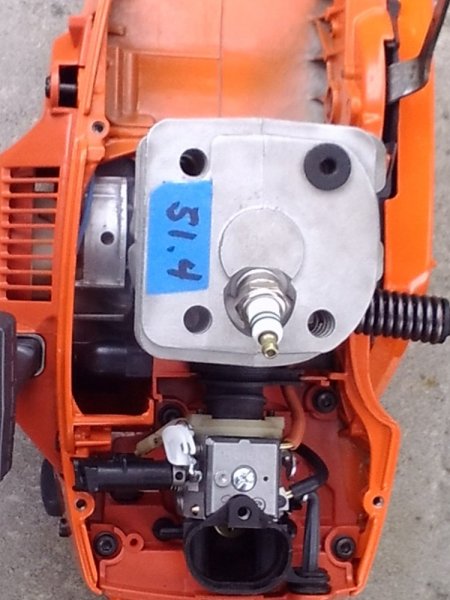

  19. KilliansRedLeo
    KilliansRedLeo
    Jun 14, 2014
    1,267
    2,810
    Rochester, New York

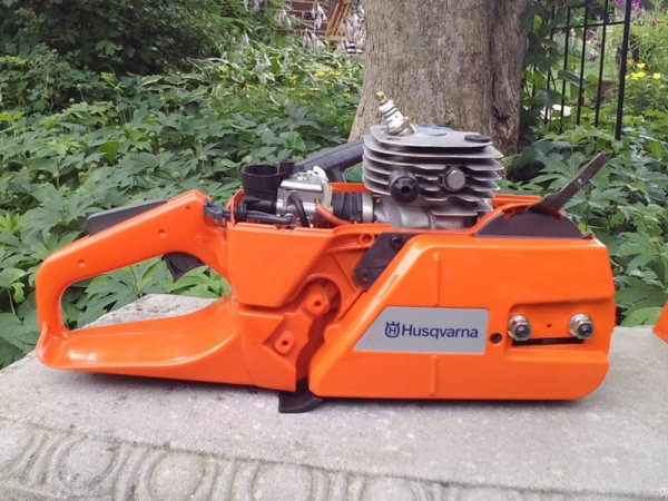

    Got a little further along. Still waiting on HVA for some small parts but here is where we are.
