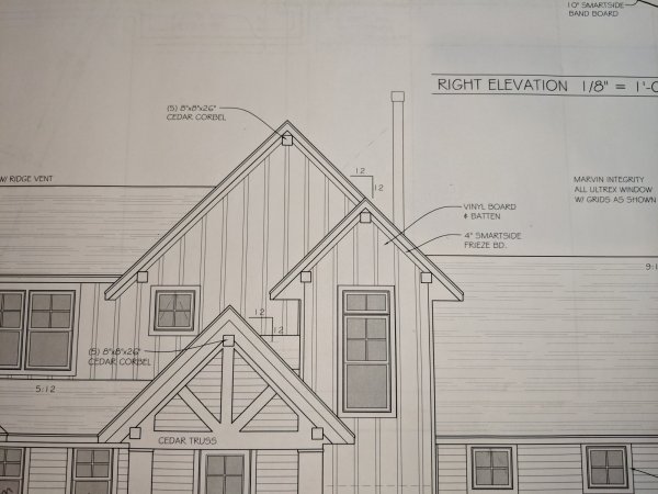

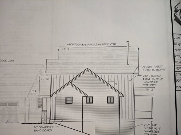

    Hey everyone, I've been reading from this site for awhile and have learned a lot but now have a question for the experts. My family and have started to build a new home and we will have our first wood stove. I grew up burning a lot of wood but it was always in fireplaces. I've purchased a Woodstock Progress Hybrid. While I have pretty good handle on the stove itself, I am looking for recommendations on solving a tall flue issue. The home is a walkout with 1.5 stories above the basement. The main room where the stove will be installed has tall vaulted ceilings and the stove will be installed on a raised hearth in the corner. The stove pipe will exit the home on the lower end of a 12:12 roof line and then extend 8-9 ft in the air to clear the peak of the roof and meet code/draft requirements. Because the pipe will exit on the walkout side of the home it will be a 3 story fall if you would go off the roof. I also have to somehow get 9 ft in the air once I'm on the 12:12 roof line. I'll attach some pictures for reference.
    I'm looking for ideas on how to best clean a chimney like this. I'd like to pipe to come straight out the top of the stove. Getting up on the roof isn't the problem. The problem is getting to the top of the pipe once I'm up there. I have a couple of ideas in my head ranching from framing in the pipe so I can lean a ladder against it to installing a steel grate platform on the roof that would allow me to harness in and walk out to the chimney. I'd appreciate any ideas on how to best solve this problem or at least make in manageable and safe. Even if I would hire a chimney sweep to handle it I still have to convince someone to do it. Thanks and great to meet all of you. Seems like a great group.

    The pipe is usually in 3 ft sections. If you are happy with going up there (I wouldn't be), it could be disassembled each time for cleaning.
    I wonder if a sooteater could go that far from the bottom?

    Bushpilot - I asked that very question to company that's going to help with the install. They said that the pipe that goes to the outside would be crimped and very difficult to get appart. I also asked them about coming out the back of the stove and then going straight up but they said the length of cleaning rods required with the short clearance above the floor would be difficult. I'm also not the crazy about going up there. Well, I guess I'm more worried about the coming down part :)

    I sounds like Ashwatcher might be using a sooteater? It looks like they sell it with as much as 39 feet of rods, so maybe you could use it? You could always add more rods, but there must be a practical limit.
  6. billb3
    10,334
    53,372
    I'd go out and up. Over what looks like a back deck. Through that deck's/sunroom's roof if it has one . Exposed or with a chase with an acccess to the bottom clean out.
    Or use a sooteater up thru the chimney inside.

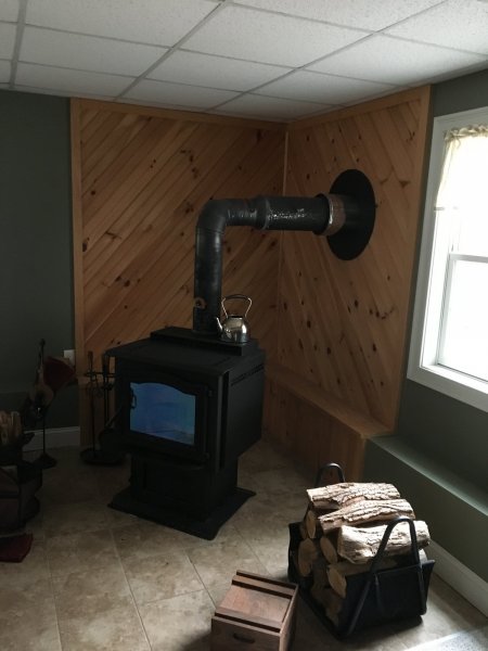

    BE43ABA3-8EBF-4E16-A666-137CBD813855.jpeg Our wood heater is in the basement and it’s roughly 28 feet to the chimney cap. After seaking advice on this forum I purchased two soot eater kits. Purchasing two kits was only a few more bucks than just getting extra rods. I am able to clean from the bottom with no issue. In a pinch, I can also put a ladder on the backside and shimmy across from the top to inspect the cap. Hopefully the bid for boxing your pipe in is reasonable. For me,being able to visually inspect
    from the top is important.

    Central stove placement is a great plan for the best heating of your home...and internal chimney is usually preferable, but in your case with a chimney that tall, external would be fine too, you will have plenty of draft...too much actually...you will need to install a damper in the stovepipe to keep draft under control.
    Whatever you do, you will be able to clean from the bottom with a Sooteater...as was mentioned, buy 2 kits rather than just the extra rods...and there are ways to clean from the bottom, from inside the house, with no mess. (internal chimney)
    But if you can work it out to have the chimney close enough to the roof, or peak, so that you can access the chimney/cap if needed, that is best case scenario...could save you some headache someday...
