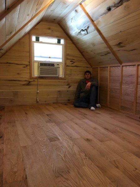

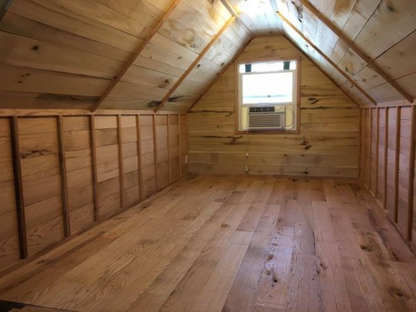

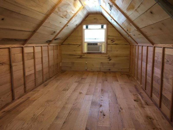

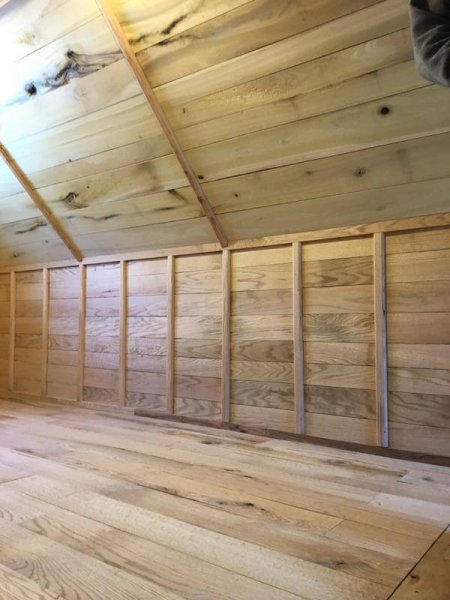

    Was able to get some time off work, and got the floor in the loft. I think it was 96 sq ft. It came out pretty good. Now back downstairs to finish up the bathroom. More pics to come. 17203747_10210859795387461_1987254742_n.jpg 17203964_10210859795627467_1523373082_n.jpg 17238819_10210859795667468_1187860833_n.jpg 17270310_10210859795307459_978423475_n.jpg 17270870_10210859795467463_624754395_n.jpg

    Thanks!! The floor is 3/4" oak boards that we cut on the sawmill (lots of them lol). The room will be a bedroom in the cabin.

    Got some real tight joints in that floor judging from the pics. Great job!

    Thanks! We ripped all the boards to the same size and made sure the table saw was cutting real square. I had to hand plane the sides on quite a few boards to get the fit just right.

    Why the verticals on the walls?

    Thanks! We put the verticals there to cover up seams. The trusses were not made perfect (thats what happens when you get a couple amateurs making trusses lol), and so the boards didnt line up great there. Also covered up nail holes.
