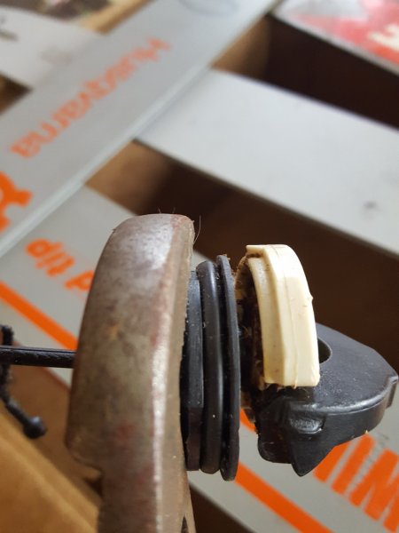

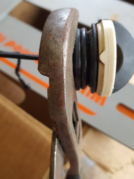

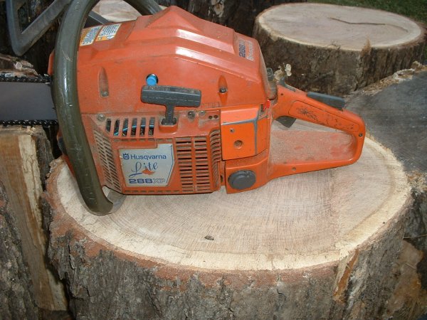

    Your cap is in the closed position. I just came to the shop and played with one. You need to unlock it to get the lines aligned. Try using pliers CAREFULLY. Don't squeeze hard. The first pic is the closed poison. The second is open . See the gap in pic 2. 20200412_121507.jpg 20200412_121523.jpg
