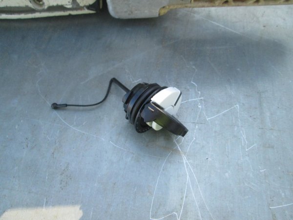

    Replaced the gas flippy cap on my 460 today as the old one would leak on occasion and wouldnt "seat" properly. A PITA when it leaks, especially when you don't know it is.
    Are these universally sized...will the same one fit my 290 and 261? Bought two and have the spare in my toolbox. IMG_1389.JPG

  2. BuckthornBonnie
    BuckthornBonnie
    974
    3,207
    Penn Yan, NY
    For the most part, yes. There are flippy caps for trimmers and smaller units that are smaller, I think.
    Part numbers correspond for your 290 and 460.

    I believe the O rings are replaceable on those Brad. I'll check some of my IPL's when I get back to the laptop. Some may be interchangeable with some models but not all. I was getting parts at my dealer last week and he has a big drawer full of various sizes and types of caps.
  4. farmer steve
    farmer steve
    Feb 17, 2016
    1,966
    14,375
    top of the hill york co. PA.
    buZZsaw BRAD. The gas cap for the 290 and 460 are the same part # and should interchange on your saws, different part # for the 261. The O ring is replaceable. The part #for the O ring is 9645-948-7734. The O ring is the same part # for 290, 460 and 261.

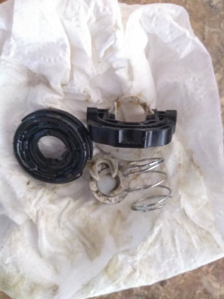

  16. wildwest
    30,151
    141,433
    Wyoming high plains
    WWW's just died. Is there a better kind or just buy another one?
    Pic coming soon. (I think it's a flippy cap, is it). Good news is it lasted 20 years.
  17. farmer steve
    farmer steve
    Feb 17, 2016
    1,966
    14,375
    What saw?
    Screwloose, T.Jeff Veal and wildwest like this.
  18. wildwest
    30,151
    141,433
    Wyoming high plains
    MS210
    Stihl
  19. farmer steve
    farmer steve
    Feb 17, 2016
    1,966
    14,375
    Yep that's a flippy cap. Never saw one busted up like that. OEM is probably the best bet. Not a fan of of chinesium.
