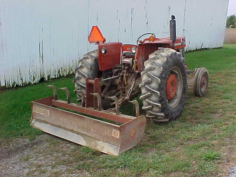

    I run a dozer to get it close and the the box grader to finish it. It's so quick and does a great job. If dad is around we'll run both at the same time. The cylinder in the 3rd link allows you to have instant dig or drag because you can control the pitch of the blade while driving in the seat. If you just use the normal 3rd link screw you have to get off and constantly change it. Makes final grading like childs play. Gravel driveways are great with them too as I have a longer driveway as well. Easy to ridge a driveway with them if you want that.
    Just has the old screw link in here.
