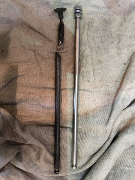

    Pic 1 - Old cleaning rod with boot vs. new cleaning rod with Stainless Steel nuts and lock washers

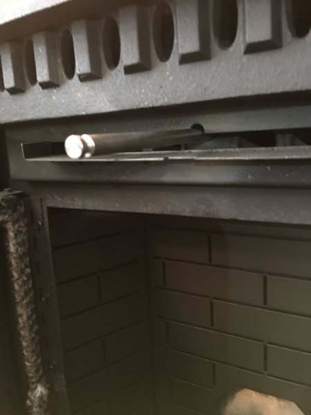

    Pic 2 - front of stove

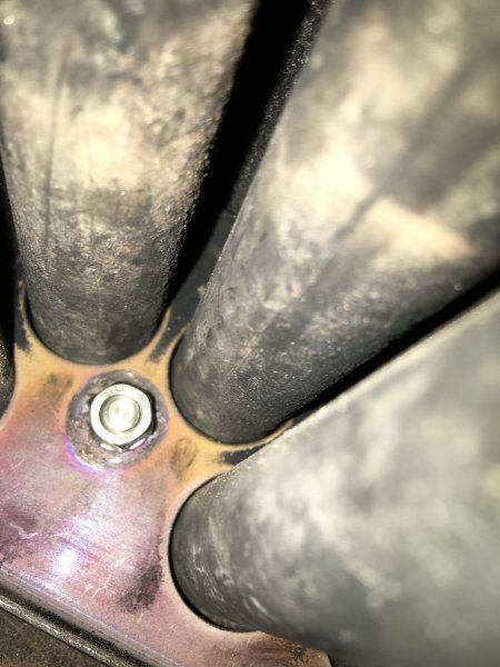

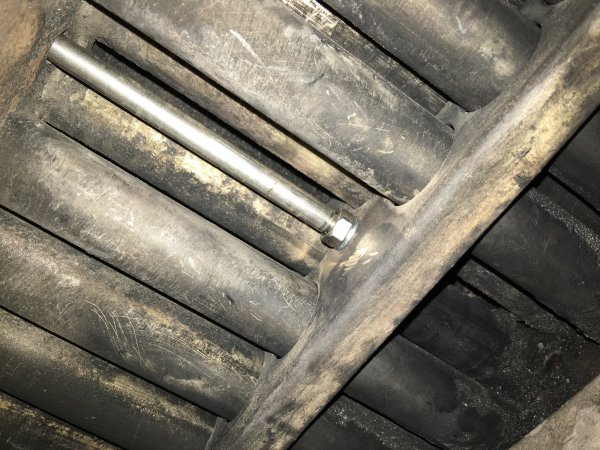

    Pic 3 - front of cleaning rake with new rod installed.
    Pic 4 - Back of cleaning rake with new rod installed.
