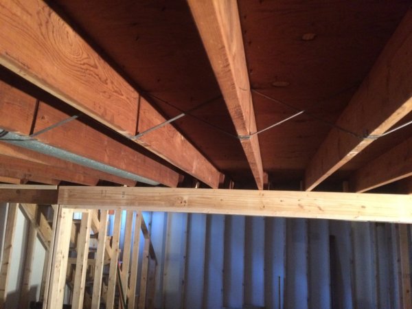

    then I removed the strapping to get access, I was able to slide the piece in and pull it back on top of the other wall, remember to install with the crown up

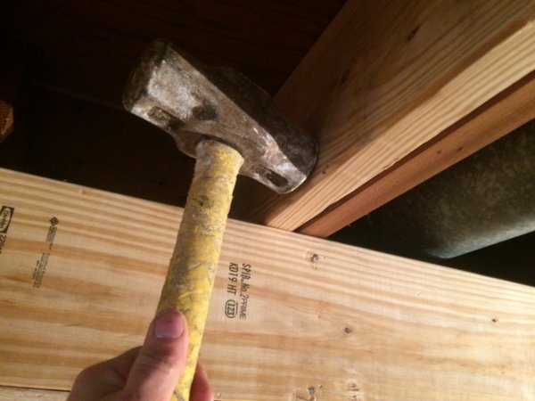

    Had to use the Big hammer to rotate them into place and seat them together

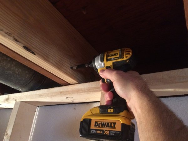

    then I fastened them together with 3" deck screws

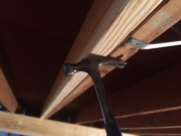

    A little trick to line things up is drive a screw into the adjacent board, then use you hammer to align the board edges as you drive the screw to join them.
    had one that would not go back into the pocket so I screwed a block onto the edge of the joist and then used the Big hammer again to move it back
