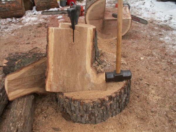

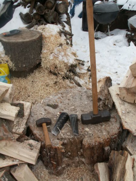

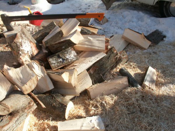

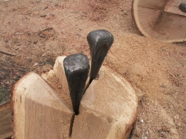

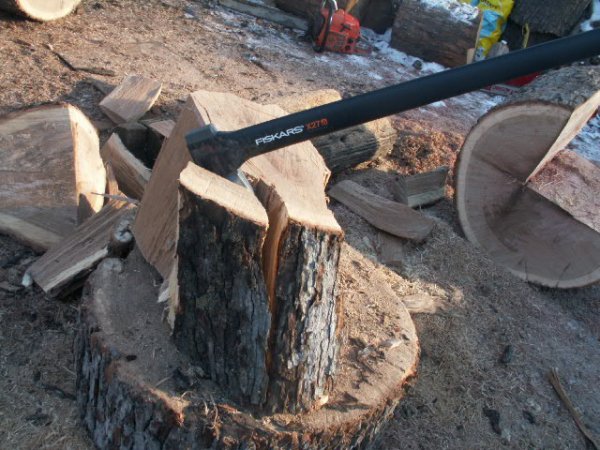

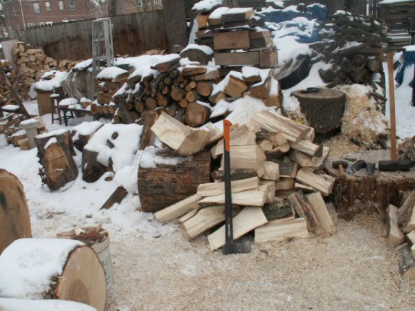

    Love my X27. Bought the X25 in May 2011,split 20+ cord dead mostly red/white oak over next 2 1/2 years.Sold it on CL 2 months ago.
    The X25 was great but wanted more power/leverage with the longer handle so bought the X27 in Dec 2013.
    It will bounce off some gnarly stuff,even as small as 8"-9" but works good on bigger straight grained ones if you attack the outside first then bust up the remainder. On most extra large tough ones I have to either half or quarter the logs first with a big saw, and/or use 20lb sledge/twisted wedges then its much easier splitting down the chunks.
    But all in all its a great tool,it splits 90% of my yearly supply without any problems.I've been splitting wood for almost 35 years & have seen pretty much every kind of manual splitting device out there.Some things work,some don't,some are just a 'fad' that don't stick around. But the Fiskars axes are the real deal.

    Nice pics Thistle. Are you slowly saving for a hydraulic splitter for when you need to start doing less manual splitting? There will come a day when ........

    Thistle, are both of those wedges Helkos? I love mine. I have one of those and a Gransfors. It's small though. Good for tough starts. But, the Helko wedge is a warrior!

    1 is Helko 5.5lb (approximate),1 is a Mueller 4.4lb from Austria.The Mueller is hand forged,the Helko drop forged.I also have the Wetterlings twisted one roughly 3.75lbs with 'teeth' on one side.Its good but not quite as "quick" as the others.
    The factory angle on the Wetterlings was a bit thick,it was hard to penetrate without constantly bouncing out,until I thinned it out a little with the 4.5" mini grinder.Made a world of difference.
