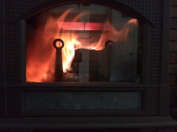

    IMG_1251.JPG IMG_1252.JPG Very quick and easy. I get what looks like greenish brownish corrosion on my cat. The spaying took in right off. Cat is much more responsive now.

    Cat had become very inactive again.
    I did a soak in 50/50 vinegar-distilled water for about an hour. Rinsed. Working great again for now. Cat is just over 5 years old now.

    I did the spray method today. I spray, let it sit, spray more, shake out any excess, spray a little more (likely hard to do too much spray if the other option is an immersed boil!). I used a tall, narrow container to dip one end and then the other for a rinse in distilled water. Burning beautifully tonight.
