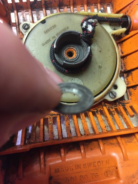

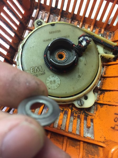

    3C196F72-695B-481C-8477-836295CDB2CF.jpeg G FE02AC92-4E1B-4484-AD80-8342F9E5EEF0.jpeg
    To add a little more info.
    Wrenching on a 154 SE this afternoon so I pulled the starter to look at it and noticed that on this model there was some thought put into that washer. The spring side has a shoulder built in to rest on the plastic post. The other side has slight a bevel to accept the screw. This would keep that friction from happening.

    Wow thanks for posting that...my washer is similar but the machined edge is not so high ...maybe the wrong washer was installed at some time...anyway my little shim replicates that...
    I took it out and cut a load of wood with it today...took some time to clean up and run good but it sure does rip now...
