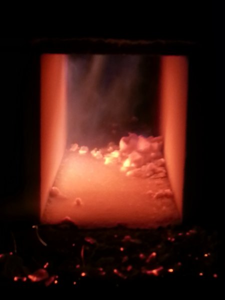

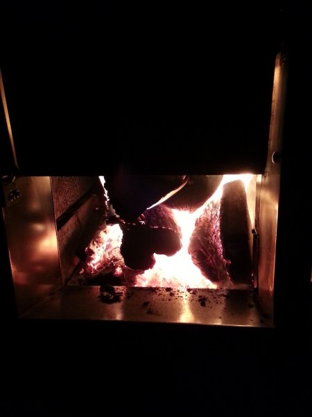

    In the crate until this year. I installed it in my milk house. Along with a heat exchanger then connected it to my smoke Dragon and installed 3 way valves to my house and shop to have less heat loss from my under ground piping. Its an older version so I e-mailed profab and they sent me updated changes I completed them in about two hours. The boiler was up to temperature before I could clean up my mess. Boiler 175° boiler return 167°. loop 171° house return 140° 20141104_171943.jpg which is setpoint.

    Sorry about the extra pics still learning attaching files and previewing.

    Very nice! Gotta love a gasifier.Looks like your getting a pretty good secondary burn.
