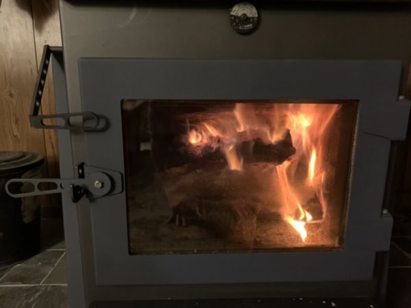

    Yup I pulled the trigger.
    The forcast low for tonight was mid 40’s so after work I made sure the stove (Ideal Steel), chimney and whatnot was good to go in case I decided to light it up.
    I also put fresh batteries in the CO detectors - smoke alarm batteries are changed each spring.
    At 11:30 it was 47 out, low 60’s in the house - so I built a nice 8 split fire in the IS. This years wood Supply is mix of 28 month split & stacked Ash, Silver Maple, and Locust with a wee bit of Pine.
    Stovetop is now 440 and the stove room is warming up.
    BTW - Woodstock rebuilt this stove last October - I ran it from mid November to end of last season. Gave it a good look over tonight - still looks good - no cracks!
    Before you start your first fire of the year be sure to give everything a good one over safety check.

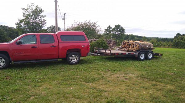

    Picked up 2 bundles of slab wood today. The oldest son helped me clean the chimney and replace flue pipe from the wood stove to chimney. Creosote came loose real easy. I used 2 of the creosote cleaner logs at the end of last season at 2 different times. Basically one complete push and pull through the chimney broke it all loose.
    There was more buildup than I would have liked. Guess I'll need to do a mid season cleaning this winter.
    Trailer has one bundle on it.

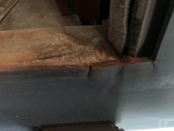

    Chance04 - yes my stove had cracks and other issues, they did rebuild it. I sent it back in mind October 2019 and got it back mid November. At the time I was unaware they were rebuilding stoves. I was having some issues, it was getting increasingly hard to fully engage the cat, that last 5% of handle travel to engage the cat would frequently “Catch” and not complete it’s travel. Also when I got the cat fully engaged I noticed more smoke out the chimney than I thought normal. Stuff in the top end of the stove was warping/bending and I had a crack in that upper right area of the door opening.
    In getting ready for last years burn season, in late September I cleaned everything out, took pics and emailed Woodstock about the issues I was having. We then spoke and they offered to rebuild the stove. Here is pic of the cracks in my stove, Sorry, the pic is rotated 90 degrees.

    Mine had the crack in the corner and you could run your finger along the face and feel that same crack you show in your pic basically forming just below the drop-down flap/airwash area.
    Have you felt for any distortion in the corners or where it cracked before?

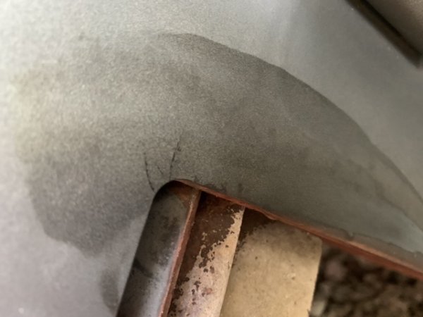

    I looked today on how it’s doing- smooth an silk but interesting looking lines - they are not cracks - see below. I set the area before taking the pic so it would shame out a bit more.
