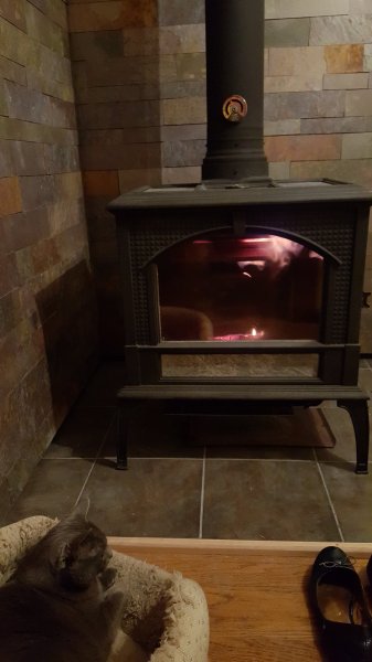

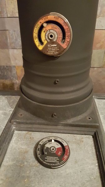

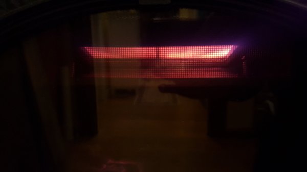

    Finished up the install and the inspector out today so tonight I lit it for the first time. A question for those with more cat experience then I, how do you judge when to engage the cat with pipe temperature vs stove temps? I engaged it when the stove was just over 200 and the pipe was getting close to 700. It lite off immediately making me think I probably could have engaged it sooner. Is that just because it's a new steel cat or do the flu temps give me a better indication of what's going on?

    Looks great! Love the hearth too. Kitty has found a permanent spot to sleep 16 hours a day! :yes:

    Very nice. Looks good. Like the backsplash and the hearth.

    Good looking hearth and stove, wfournier. I've settled on when to engage the cat through experiment. Kept closing it a little sooner each time until it failed to light the combustor (smoke from chimney that wouldn't clear after 8 minutes, cat 'stall'). It is true that new steel cats are very reactive for awhile. I rather take the stove operator manual instructions as a guide and then experiment. If your stove has a cat probe, that makes it easy. My neighbors: What's with Gark running outside in the snow looking at his chimney?

    is it single wall or double wall pipe going up. on single wall I engage cat at 300.. which should be 600 inside so what I've read smoke burns in cat at 500 degrees I like a 100 of cushion. ..

    This is pretty much what I did, before I got a cat probe. I stay under 600F on single wall pipe. When it gets to 24/7 temps its a non-issue, no cold starts.
    As the cat gets some use it will lose its hyperactivity and glow less, don't worry about it. It can be very active and be dark (900+F). Just check the chimney for smoke when in doubt.

    I have found with my cat probe I can lite off pretty quick with stove top temps in the 100-150 range. I usually engage around #2 to let the fire get going good for 15 min or so then adjust down from there.
    I use my pipe temp as well, its a good indicator if too much heat is going up the flue. During start ups or reloads I like to keep it under 500, it helps the stove and cat heat up faster.

    I'll play with it some and see when it seems best to engage the cat. It's single wall pipe going up to the class A chimney, about 4' of stove pipe and 13' of class A.

    I've never seen temps like that on my pipes. I engage when the pipe hits 300. Sometimes earlier but usually I wait till 300.

    oh and in case anyone is wondering the slate on the wall behind the stove (on durock spaced out on 20g metal studs) is cheep "multicolor" slate tiles from lowes that I cut down. I was looking for a stone veneer type look and this works for me and only cost about $1.50 a sq foot compared to the $6-15 a sq ft I was being quoted for the stone veneer. It's a little less irregular but I think it get's close enough and my wallet is much happier.

    So you just bought 12" square slate tiles, sliced them up into strips, and set them on the wall with no grout gap? Awesome! It looks like only two widths, a skinny and a fat. Is that right?
