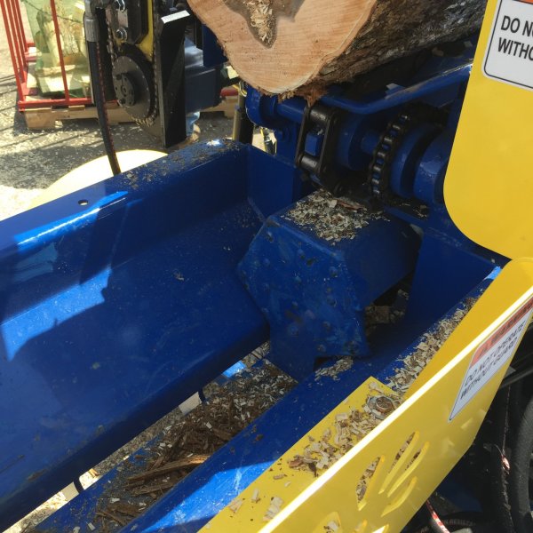

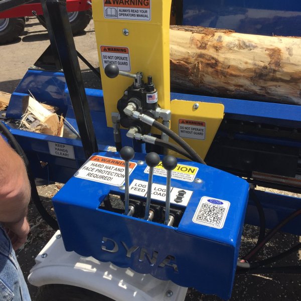

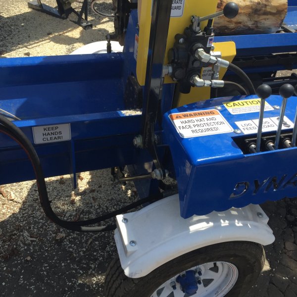

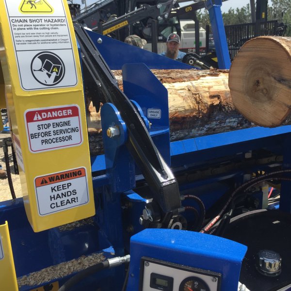

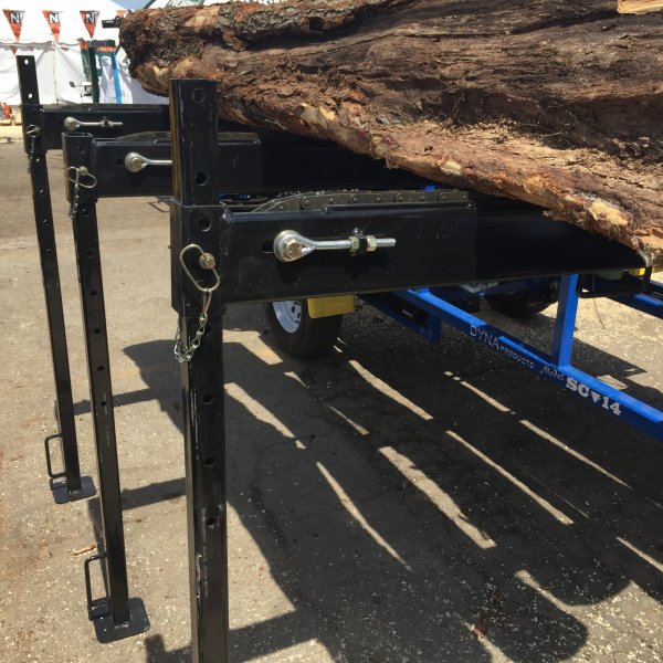

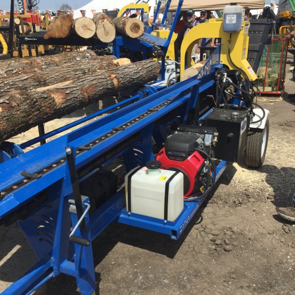

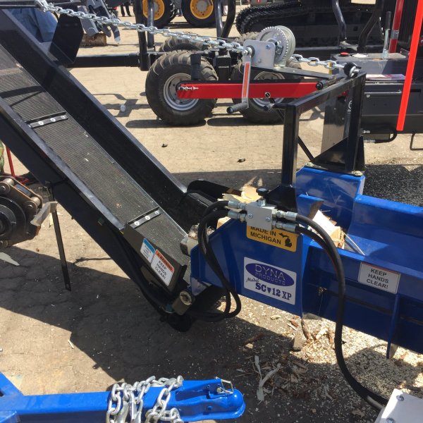

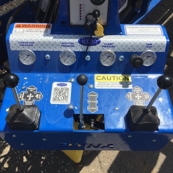

    I am in the beginning stages of this myself. I have a 22HP Yanmar diesel for power. The amount of HP on the larger processors are required mainly because they are doing multiple things at once; splitting while the next chunk is being cut for example. Those are both high flow operations. My design isn't so much built to make a living off of it, but to save my body. I can have it split and cut all at separate times. Not as efficient, but hey, I buck logs up bent over with a chainsaw then lift them on my splitter now so in my eyes it'll be an awesome improvement!
    I'm thinking of something along these lines:
    As fordf150 mentioned above, Dyna makes some low HP processors. I took these pictures of their processor at the Bangor show this past spring to get some ideas as well:

    The dyna processors are bare bones siimple designs. copying them would make for a decent build that was quick and easy. the downfall is that they are built pretty light weight. I have the sc12xp...not a bad unit and will really put wood out if its the right size wood. lighter built than i would like but the price was right.
