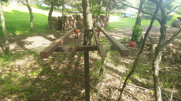

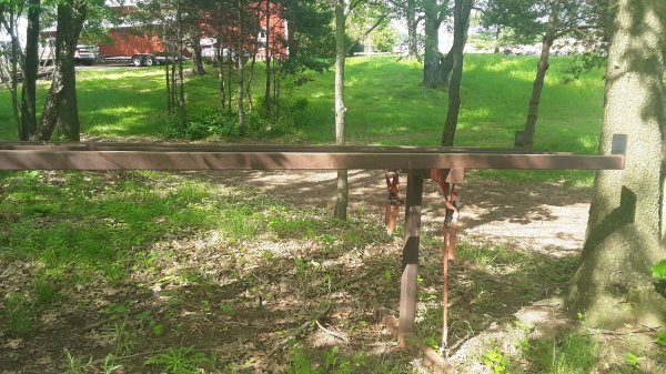

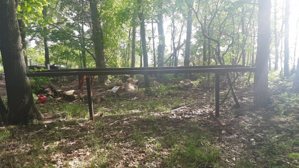

  12. amateur cutter
    5,906
    47,612
    I've got a big steel frame saw table that I got with my splitter when I bought it. Will hold 10 16" X 12' logs. May not be what you're looking for, but I'll try & shoot a couple pics & post them.

  18. amateur cutter
    5,906
    47,612
    Guy I bought the splitter from built it to help his back.
  19. amateur cutter
    5,906
    47,612
    Farmchuck here's a few pics. Thing works well as far as height. The straps are tie downs to keep it from nosing over when loading downhill. It's set out of the way for the moment as I rearrange my processing area for the conveyor. I let the rounds drop & roll them to the lift table on the splitter. It's nice & heavy duty, bars are laid out to minimize the chance of hitting it with the chain. 16" 18" & 24" lengths are pretty easy to make on it.
