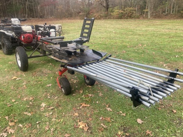

    The Grizzly bars are worth it in my opinion. Much depends on what you plan to do with it. I dump my wood into pens and leave it. The first year I had no bars, wasn’t happy with what I was seeing. The small junk falls straight down into the middle of the pile and stays in the middle. The worst place for small junk that blocks air and holds water.
    Anyway my bars are off the splitter not off the conveyor. I just didn’t want to lose any height. I get at least 50% of the scrap. I’d guess they would get more if they were on top of the conveyor where the wood and scrap actually separates for a moment as its falls. I’m happy with what I get anyway.
    Oh,,,I have a box wedge which helps push wood over the bars. Without a box wedge I’m not sure how well the splitter would push wood any significant distance
